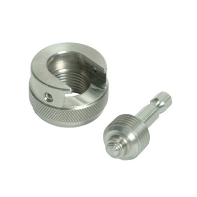

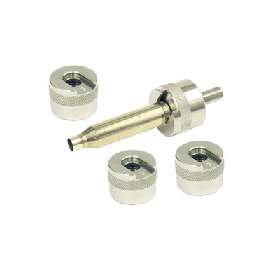

What are you using to grasp the case rim and then chucking in a drill. A ding in the rim or the case being off center in what is grasping the rim will cause the wobble.
My Lee case holders will cause wobble but my Sinclair case holder centers the case on its primer pocket. Its not the drill jaws that cause the wobble it is what is holding the case rim and if the case is centered and not tilting.
It is very easy to get the case off center with the Lee case holder.
