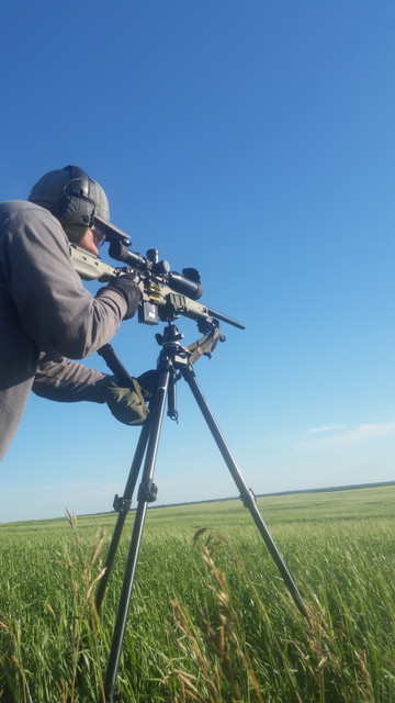

I was nailing a 10" gong at 680 meters pretty consistently with this setup. Not that it's anything special but what I do is throw my sling over my folded bipod legs so it pulls from the right hand side and then grip the sling against a tripod leg with my left hand. To add tension I just twist the sling around the leg a bit.

Here's another picture of my setup just because I really like how this picture turned out and I'm showing it to everyone:

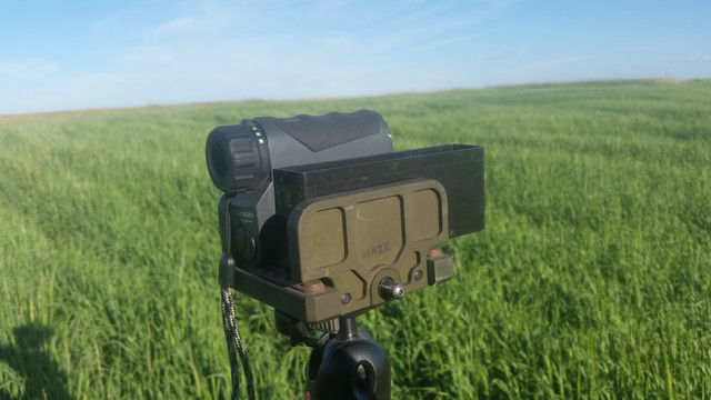

With a little creativity you can use a HOG Saddle for a lot of things:

As we all know, it's about whatever works for you. I dunno if you have a flush cup on the bottom front of your stock but I just detach my sling from the front left (where I usually keep it) and clip it in on the bottom so it's tensioning straight down. The only reason I like being clipped in when standing is so that I can put my support hand on the ballhead and apply forward pressure. For seated I always wrap it around a leg. But again, it's about whatever works for you, figure out a system then practice getting in and out of it.
I used to do the same thing with my Kilo in my Pig Saddle but I know a guy down in Wa who 3D prints a tripod adapter for the Kilo 2000 (pretty much exactly like the one that comes with the 2400) for like 45 bucks. I got him to make mine with an Arca dovetail on the bottom so that I can just remove the saddle and slide the LRF in. Works awesome. I'll shoot you his contact info if ya want? I just keep the adapter on the LRF all the time as it still easily fits in the pouch for it on my belt like that. I shoulda showed you the "tactical table" at the match last weekend. It's another attachment for the tripod we use sometimes. Doesn't weigh much and can be super practical, mainly in field matches though.

I have the 3D printed Sig Kilo tripod adapter but only one QD mounting plate (with no anti rotation pin so the saddle spins around on the mount lol) so this works for now. I just use it for a spotting scope 90% of the time.
