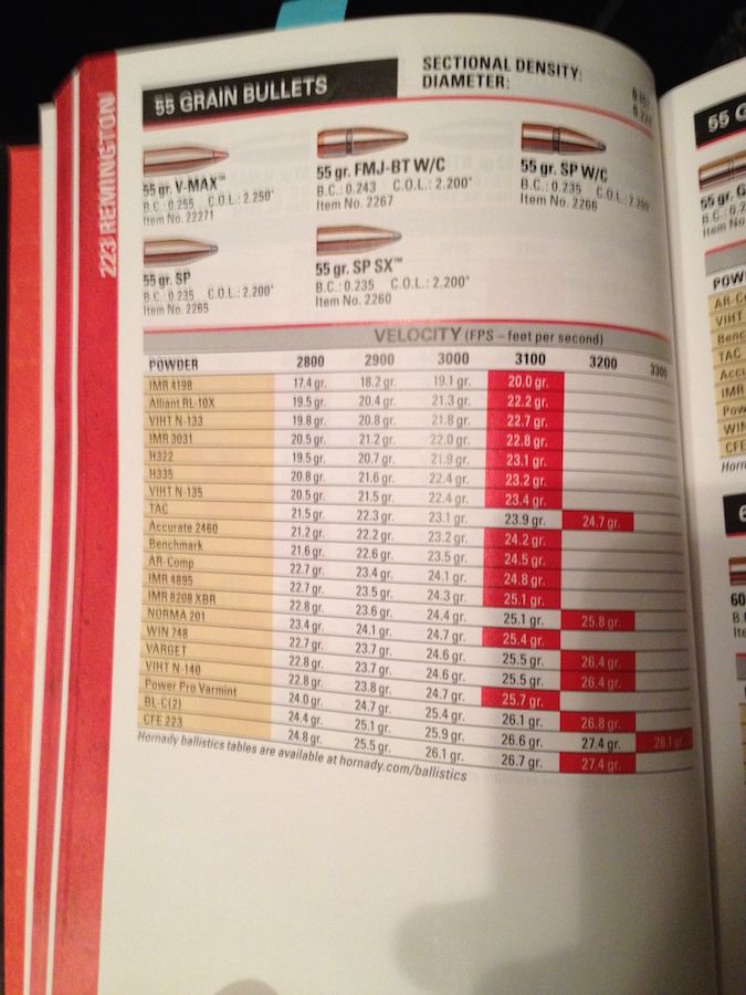

Hey guys. My old man wants me to load him 55gr Vmax .223 rounds for his xbolt
I don't really wanna spend the cash on a hornady manual for one load so could one of you fine fellows tell me the COAL and the minimum and maximum load with Varget?

I have a thread going, in the reload section. Page 2 , there are pics of the hornady manual , for .223 in 53,55,60 g, rnds. Look at "anybody reloading 53 g vmax" all the vmax data is there.
You don't need a Hornady manual or data for a V-Max. You load for the bullet weight, not who made it .

Hornady manual ,Speer manual and hodgdon have different load data. I'm using hornady projectiles, so thought it best to stick with the hornady manual.

Opinions vary on this subject. I've been reloading for three years and still prefer to go with the bullet manufacturers load data. If I use another bullet manufacturers data I do it with a lot of research and load up very carefully. I don't think wanting data that is available from the actual Hornady manual is bad idea at all especially when loading for someone else.
Side note, the loads for the picture shown, if there out the 9th edition, where tested from a 26" barrel.
Not sure if that's relevant to your needs, but figured I'd share anyways.
