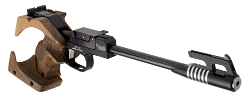

I am looking for an air pistol to practice with indoors in the winter.
I think I have settled with C02 power.And probably a TAU 7 If I can find one .
But at the price and availability I must also consider a Crosman 2240 or 2300T.
I know there are some upgrades that can be done on the 2240 particularly the steel breach and the trigger.
My question is . Would you folks buy a 2240 and upgrade or buy a 2300T or go farther yet to a 2300S.
I intend to use some sort of optics, probably a reflex sight so,
Take the sights out of the equation and power, as the only thing I intend to kill is paper. So it comes down to inherat accuracy and trigger whitch will for me greatly efect shootability.

For the cost of all the lipstick you need to put on the 2240 to make it shoot as well, not to mention the time, go for the Czech made air pistol right out of the gate. You'll be glad you did.

Of the two mentioned, I'd pick the TAU7. Had one for a number of years. Worked great, using a old extinguisher for bulk refill was convenient (and easy).

For a little more $ than a TAU, you could also get a Pardini PCP

I ordered a TAW 7 from D&L last week. It should be here about Thursday . I think I might have to take it out to the shop and give it a try even if it,s not winter. The single shot feature is not an issue for me as I am a bullseye shooter and rarely shoot rapid fire. The PCP guns look interesting, but considering the cost of guns and related compressed air tanks and pumps, I did not want to git involved to that degree for a bit of winter practice. At least not yet LOL.
