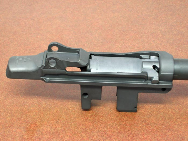

That is the product I use. Whole guns. Very easy to use, excellent results. I blast, degrease, rinse, and into the tank. When the colour is right, rinse, dry, oil. I don't like the idea of parking bores, so I plug barrels.
Used PJ's over 10 years ago or more on this M1 trigger group, still looks as good today.
