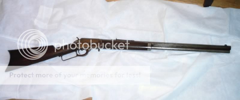

I've got dies and brass coming (working on the lead part), and I'm looking for a mild load for 38-40 cast (probably a 180gr slug). It's for a Marlin 1889 (made in 1894) so I don't want anything too snappy out of it. I have some Titegroup at home - any recommended recipes involving that? Or would something like Trailboss be better suited for a low pressure round in a bigger case?

I'm hoping she'll be a decent shooter:
With the 38-40, there are no published powerhouse loads listed that would harm your rifle.
