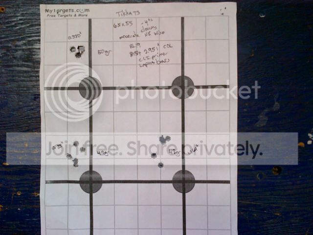

Had some range time today with the same loads I chrony'd during winter. 129gr IB w/ 50gr of RL19 and CCI 200 primer - I was getting 2720 fps @ -6C ... today at +8 they were at 2815fps.
I also chrony'd loads I had made with H4350, 95gr VMAX w/ 47gr of H4350 were running 2820fps @ -8 ... today at +8 2850fps.
Probably old news, just thought I'd share for discussion sake,
Are you happy with these velocities or are you going to try and get some more out of it? FS
I'm never totally happy but I'm quite satisfied with them :) The kind of accuracy I'm getting out of the 129gr IB load makes up for a lot. I was able to get more velocity with H4350 but accuracy dropped off,
