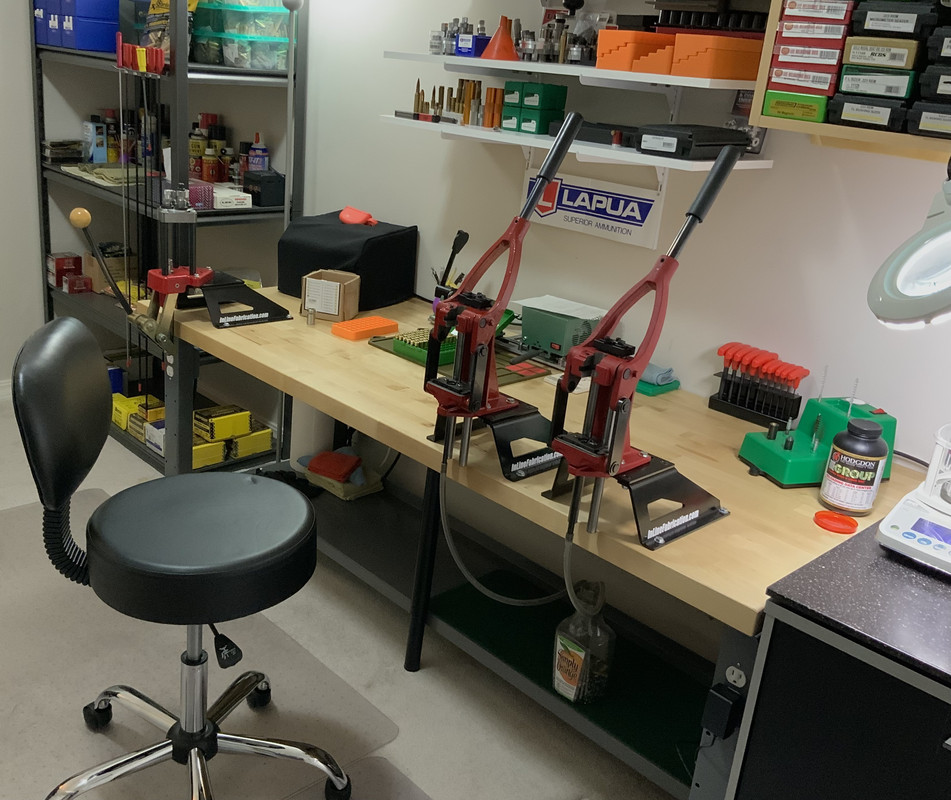

My solution for catching spent primers on a Co-ax was to first get rid of that silly cup. You can see on both of these Co-ax's, tubing that routes into a large bottle that really works well. The tubing is clear so you can see that the primer has been extracted from the case.
A simple, yet elegant solution. Rory, sorry to go off topic. I can appreciate your struggle with the Co-ax. I hope you find something that works well for you.
