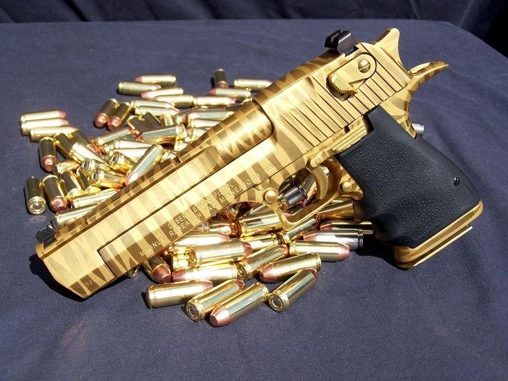

I personally don't want a TiN Gold Coloured BCG, looks a little too bling for me as other have said. But if you do go that route, you might appeal to a different type of buyer and could potentially expand your product line. You could also offer other accessories like:
a nice high crown flat brimmed ATRS ball cap, with sticker on brim
diamond studded ATRS phone cases
ATRS bandanas
could make a sweet collector set of firearms if you sell with a TiN Plated 1911 or Desert Eagle!
That was WELL within the scope of "Do y'all want coatings on your BCG".
