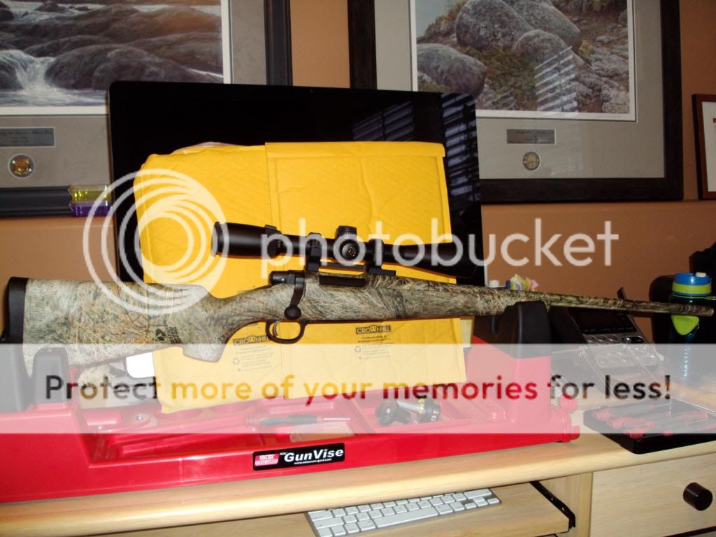

I had this faux TI 22/250 built a couple years ago with 1:9" Shilen MR contour. I don't usually shoot it more than 3 times in a string at the range and cannot see me shooting it more than that in the field.
I love the faux Ti.
