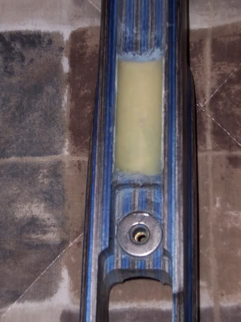

P.S nice barrel bedding on that blue stock, Jordan. I find if you bed the front of the recessed area where the takedown screw is you can prevent the action from creeping forward over time due to the pounding of the bolt.
