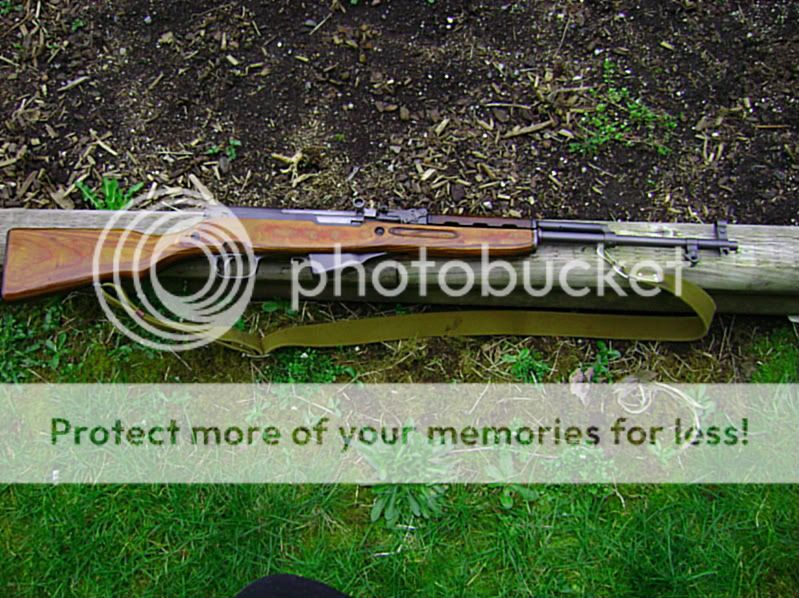

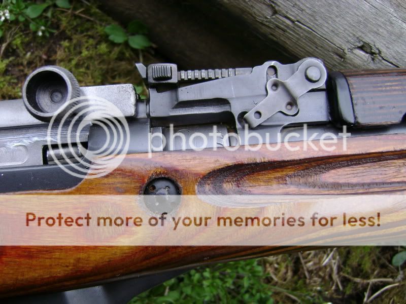

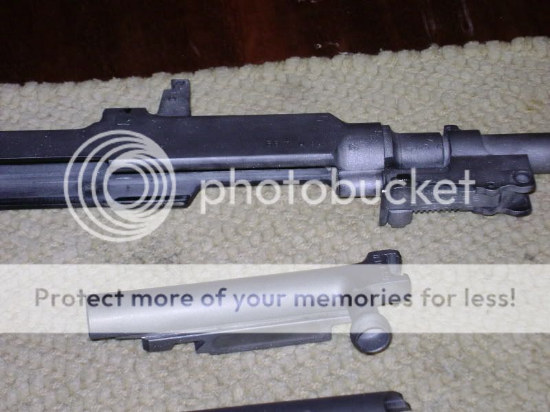

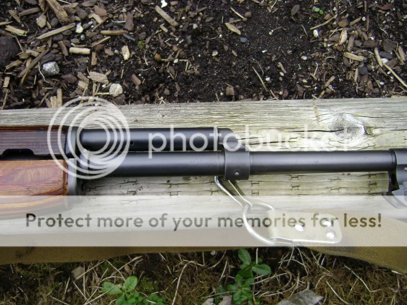

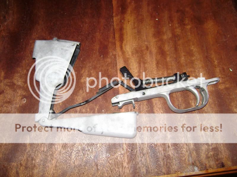

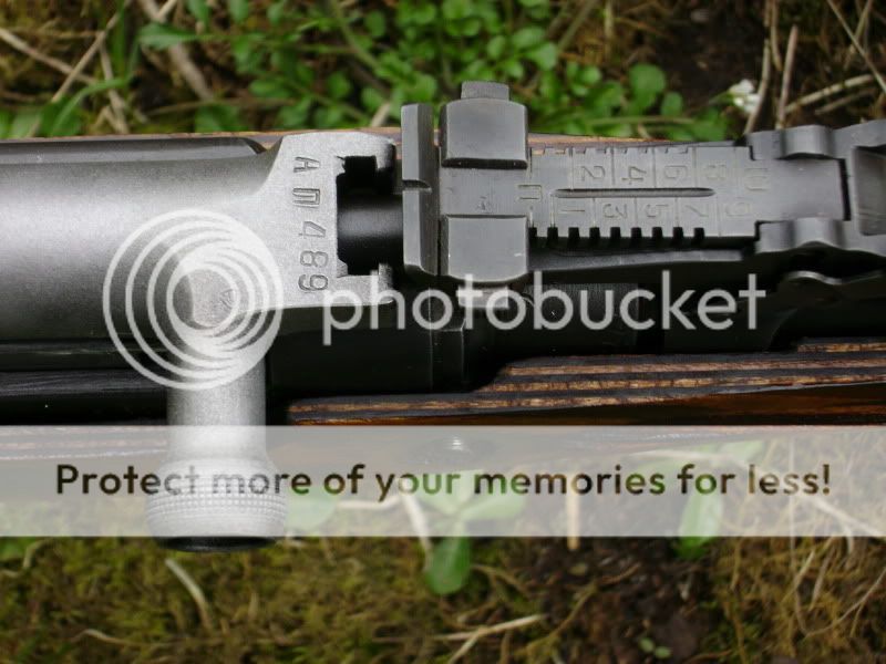

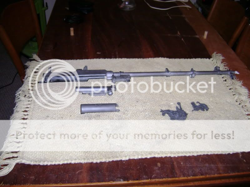

Well I finally got tired of the thick black paint on my all black russian refurb. It was the worst BBQ paint job I have seen, thick and rubber like. I borrowed a friends portable sand blaster and put glass bead type medium in the blaster and took everything off the SKS down to shiney white metal. After the blasting, and high pressure air cleaning, I rubbed all parts down with 0000 steel wool. Following the directions on the Outers Cold Blue, I degreased after sand blasting with Acetone, then washed with water. Donning gloves to not leave prints I applied the Outers with smooth strokes. Only seconds after applying the Cold Blue, the steel started to turn gray -black. I waited about five minutes while rubbing more "blue" on the areas that dried. The dried areas start to turn a green yellow, this was when I washed the Cold Blue off the steel with warm water. Letting the steel dry, I then wiped everything down with wool, looking especially for the greeny rust spots. After the steel wool I doused all with CLP. I did all pieces of the rifle including the gas tube and trigger guard. I know it was a waste of time but I'm happy with the outcome, and the rifle has a greater appeal for me. Not to mention all the factory stamps are now visible.Cheers
