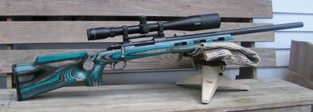

First I think it is important to realise that the thickness of the base makes little difference in the height of the scope above the barrel. The rings not the base control the height of the scope. Just how low your rings can be is determined by the diameter of your scope's objective lens, the length of the scope, the contour of the barrel, and the amount of slope built into the base.
In the picture of my rifle below, you will notice there is very little clearance between the objective and the barrel, yet the scope sits quite high above the receiver, high enough that I need an adjustable cheek piece to have a good cheek weld. My base and rings are Badger Ordanance, and the base has a 20 minute slope.
