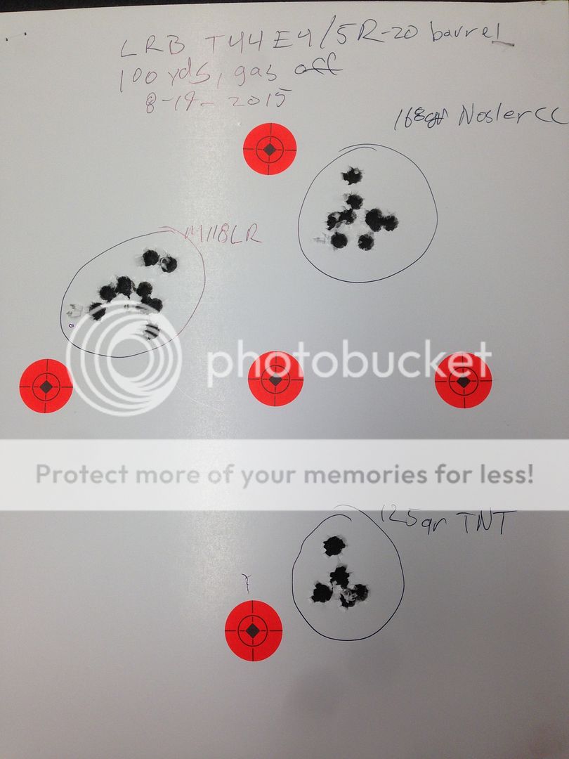

I just got back from the range tonight and I slapped on my Zeiss/Bassett/Bradley combo to test my new T44/5R barrelled build and initial results are AWESOME!
I warmed up with some M80 ball and it didn't do all that well with 10 rounds in about 4".

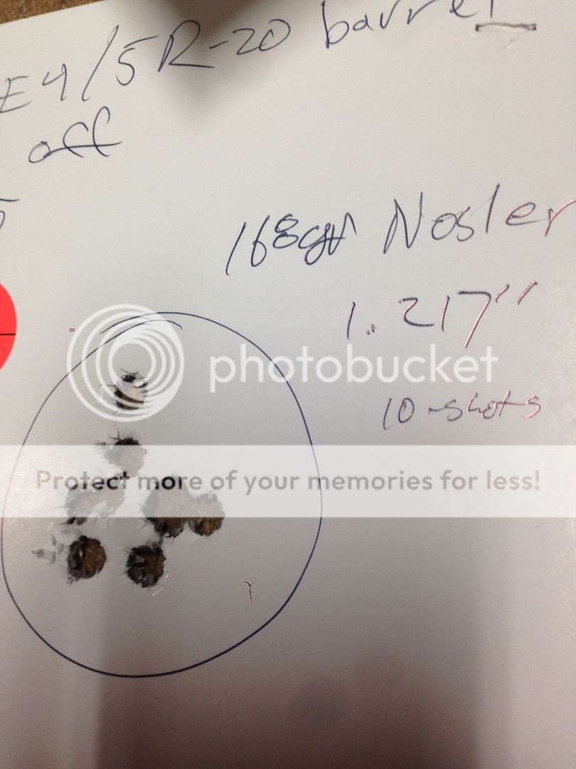

After the barrel was warmed up, I turned off the gas and fired single-feed. Here are the results...
42.8 grains of 4064, Winchester commercial cases, 168gr Nosler CC: 1.217"

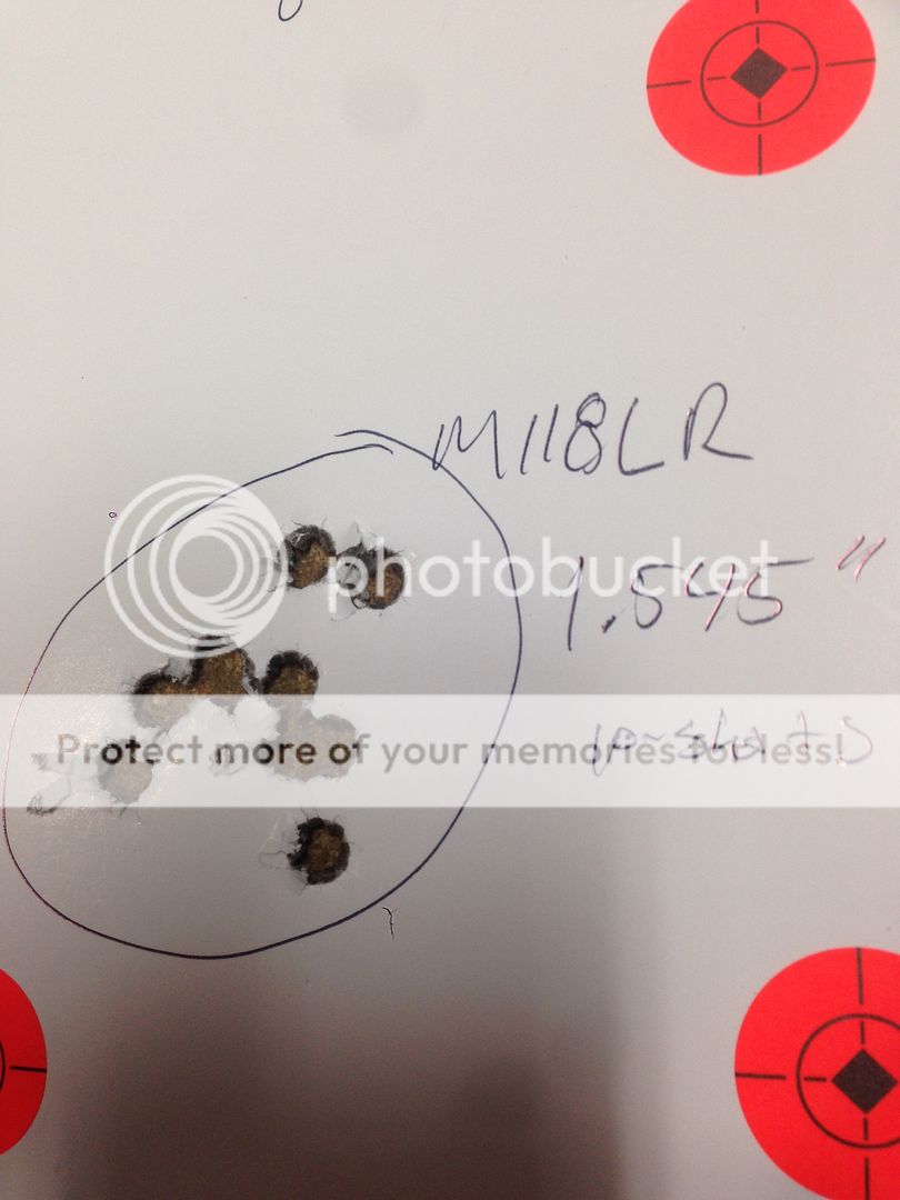

M118LR: 1.545"

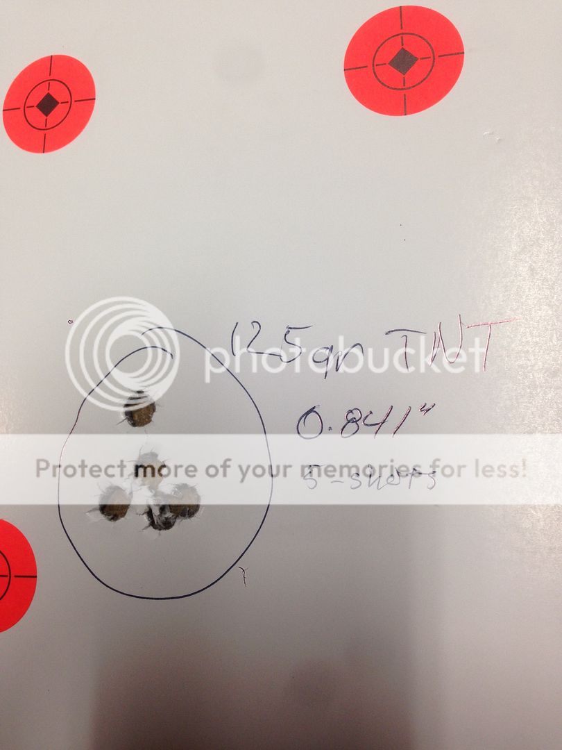

125gr TNT, 45.0gr IMR-4895: 0.841"
Looks like I already have my match loads! Now I just have to bed the sucker into my McMillan stock and see what happens!
