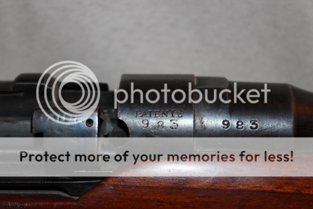

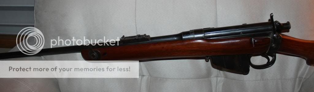

Just recently picked up an early british rifle. I am posting pictures in the hope that those with more knowledge of these guns might offer some advice and confirm or refute my understanding of what this gun is.

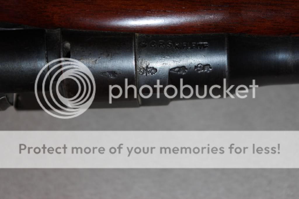

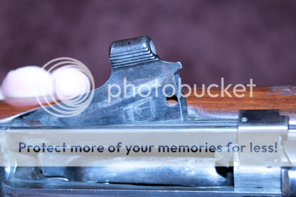

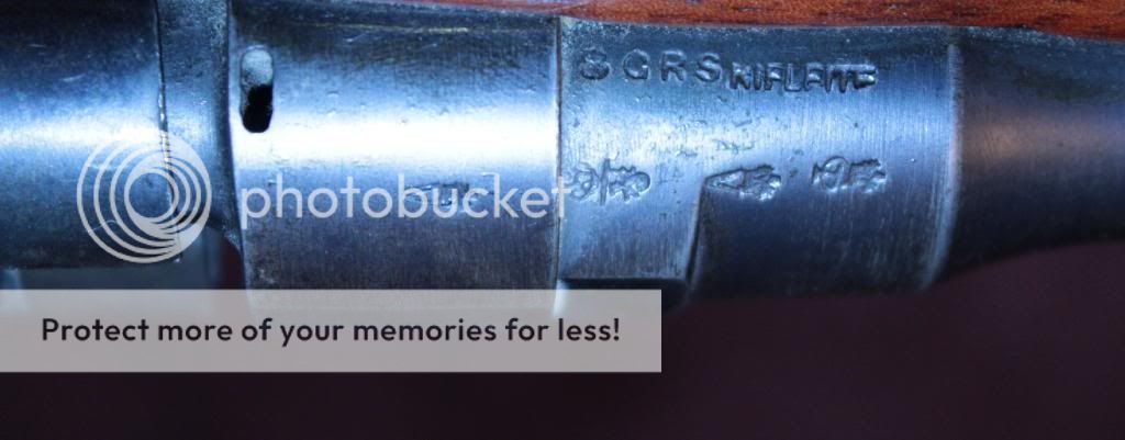

Gun is labelled as a London Small Arms MK II* (on wristband). I'm assuming (possibly incorrectly) that it is a Lee-Metford. All visible numbers are #983 (assuming that is the serial #). There are some small proof marks on the receiver that I can't decode as well as some letters. This gun seems to be lightly marked/proofed compared to any of the other examples I've seen. Volley sights are intact and plain, compared to some of the MLM guns online. On the right side of receiver it says Lee-Speed Patents, which I believe is for commercial guns only. I didn't know if that jived with the existing proof marks. On the front of the bolt dustcover you can make out another faint 'PATENT" marking. Magazine lockout plate appears to be an early 1890-1895 judging by the hole and detent tab pattern. The stock looks like a bubba-job, but it is close to the Lee-patents commercial pattern, without any of the fancy accoutrements. If it has been modified it's a shame as the wood is in incredible shape. Other than the attached pictures there are no marks on the metal to denote anything. Barrel is in remarkable shape. I appreciate any information people are willing to share. I have tried determining as much as I can, but the variability of these guns and the rarity makes things tough. Gun seems to be in amazing shape for its age and model. Maybe I'm missing something.

You tagged it correctly as a Lee Metford. It has been sportered with the full length military fore arm cut back. Let me add my tuppence worth.
It is a rifle made for the commercial trade. Military arms are made to comply exactly with a sealed pattern sample, commercial ones are not. In fact, a rifle could be ordered from the factory with a number of options. Yours appears generally to conform to the Mk.II* pattern of Lee Metford having the safey catch on the bolt, that pegs it post 1895.
My thoughts are that this one was originally made for sale to militia or volunteer units. I say that because normally, the martial designation of Mk.II* would not be there on a commercial arm for the general public sale, just the maker info. Lee Speed patents had to be shown up until around 1910 (I can't remember the exact date, rotten memory and dont have my refs handy, but I'm close) when the patents expired and no longer had to be credited.
The barrel wears pre 1904 London Proof House markings, which makes sense (London Small Arms). The 8 grains of 'rifleite' is the charge for the cartridge, Rifleite being an early nitrocellulose based smokeless powder. This info is something that also was only shown on commercial guns.
The trigger guard looks to me to be one of the style fitted to Sht LE rifles having the swivel mount lugs just ahead of the magazine. The mag also appears to be Sht.LE style. This could be a later change, or could be factory (doubtful). Are there any markings on the loop of the guard? Normally, a Sht.LE mag will not work with a Metford cutoff due to the feed lips. The right feed lip sticks up and interferes with the cutoff, hence the notch seen in Sht.LE units. Your cutoff appears to be a Metford unit as witnessed by the full width chamfer at the back edge.
Something going on with that rear sling swivel. Maybe just the pic but it doesn't quite look like the MLM screw in type, but maybe a Sht.LE unit. Does the butt plate have three screws and a long upper tang?
So all in all a very nice project. No doubt very shootable as is. Should you ever decide to restore it back to 'original commercial spec', you have a certain amount of leeway in how you fix her up. Easy resto in that it will be an assembly of replacement parts. The real challenge would be to find them, which to me is half the fun of collecting an restoring.

It sounds as if the mag issue is due to fitting a Sht LE mag into the Long Lee receiver. You will munch the right front feed lip with the cut off, if you havn't already. By the descripption of the feeding problem, I'd say the lip has been squished.
Work around solution is to get correct Long Lee mag for it (has a rounder front edge to the body, smaller right front feed lip) or, if you just need to get that puppy shooting this afternoon, pull the fore stock and take the cut off plate right out. The Sht LE mag will fit with the cut off removed and the feed lip can be tweaked back into position.
