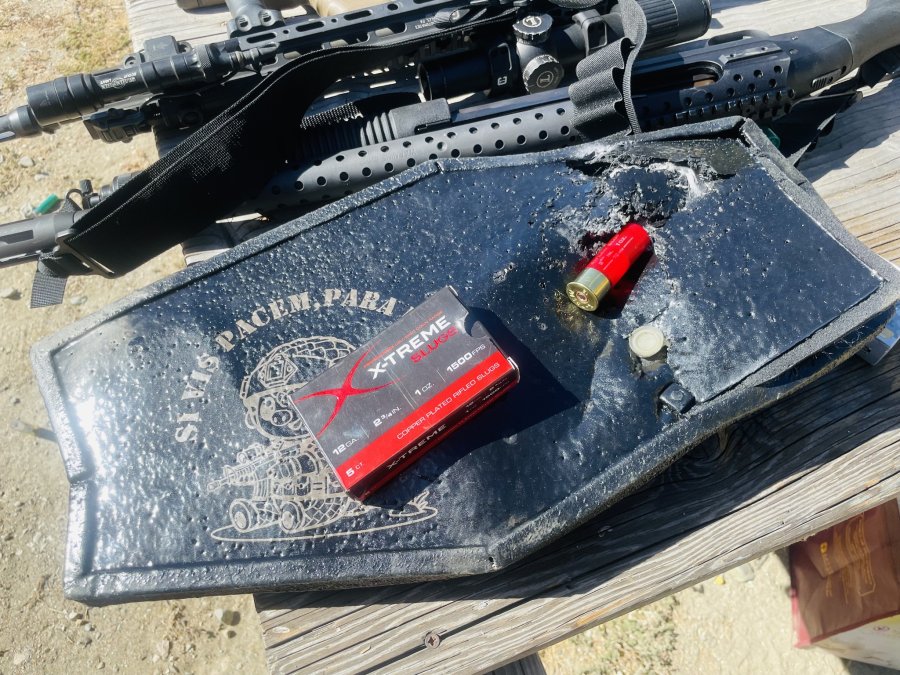

HTTI custom ultra light and thin level IIIA+ shield tested to limit Click HERE for more info
First round: 2 shots each of 9x19mm FMJ 115gr and 124gr, No penetration
Second round: 1 shot of 12Ga. Bird Shot, No penetration
Third round: 2 shots of 5.56x45mm M193 55gr No penetration
Fourth round: 2 shots using X-TREME Rifled Slugs 12Ga. 1Oz (factory indication of muzzle velocity of 1500fps), No penetration
Fifth round: 5 shots in a row using a 5.56x45mm M193 55gr, piercing on the 5th hit (as can be seen in the video below), upon inspection it appears repeated impacts on the same spot caused the penetration.
Failure point

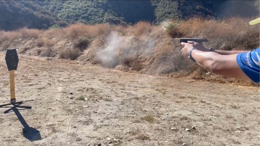

Multi-hit test (Photos, videos and testing from Polar Light-Action Proves)
Distance from Target 5 meters
9x19mm /FMJ /115gr/ 1163fps/ 1 shot/ GLOCK17 Gen 3
9x19mm /FMJ /124gr/ 1121fps/ 1 shot/ GLOCK17 Gen 3
5.7x28mm/ V-Max/ 40gr/ 1907fps/ 1 shot/ FN57
7.62x25mm Tokarev/ FMJ/ 85gr/ 1652fps/ 1 shot/Type 57
.357 Magnum /Heavy / 158gr/ 1398fps/ 1 shot/ Kimber K6S Target
