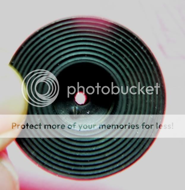

Back in those glory days of shooting I am forever talking about, a prudent manufacturer came up with an ideal solution. A screw in iris that was easily and quickly adjustable to change the size of the aperature. The outer rim is of a rubbery material, easy on the eye brow, if it happens to get too close! This outer rim turns to adjust the size from the huge aperature shown, down to a pinpoint. The shooter gets into position, then adjusts it for the best sight picture under the prevailing conditions.
This little gadget is in Ellwood Epps catalogue. They may be out of them, though, as it is a 1962-63 catalogue I am looking at!
