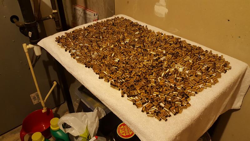

is it still wet tumbled?
I still wet tumble with about a tbsp of dish soap, a cup of vinegar, and about a quarter cup of citric acid (bought a big bag on Amazon). As 4n2t0 says, they come out very clean but without the SS pins the primer pockets are not sparkling clean. I just rinse them off, dry them, and reload.
