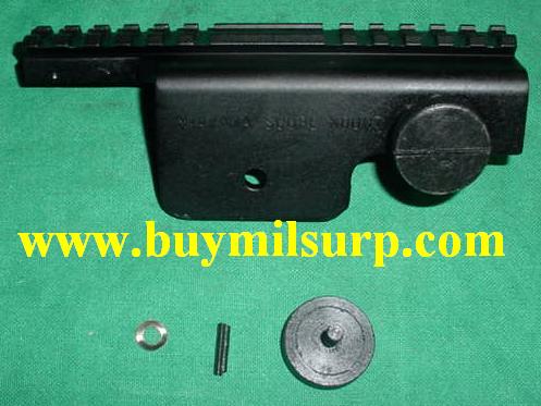

Since Canadian dollars are the highest right now. I saw a m-14 scope mount in US is only $39. Just wondering if this is the right one with good quality.

chinese knockoff of the springfield generation 3 mount- pos ,imo- a search of the stickies under battle rifles will tell you what to buy, if you want a QUALITY mount
I believe thats a piece-a-####e (B-Square style) Thats only secured by one one point....A.R.M.S#18 is a three-point mount.
I had an A.R.M.S.#18 M1A/M14 mount, which is very good. Also Smiths Enterprise are just as good; if not better.
well you're not right- look at the aft knob- also the lettering- the split pin shown is for the replacement stripper clip guide- that makes it a 3 point mount- there's 2 points right at the front being the the screw itself and the accompanying bars that lock into vertical and horizontal slots on the receiver, ( they're on the backside of the mount where you can't see them )
and the mating of the screw into the modified stripper clip guide secured to the receiver by that roll pin makes 3- therefore it's a 3 point mount, but still a chinese knockoff- it also looks like it says m-v i r on a store x00vx
