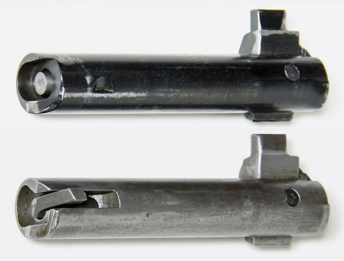

Has any one ever used a G.I. M1 carbine bolt in a late Universal M1 carbine.???. Cant sean to find any info on it.
I have had G.I. carbine with late Universal bolt . Never shot them .
I read somewhere on a different forum that the late universals were hit and miss on whether gi parts would fit or not
Supposedly the early ones were made with surplus gi parts right from the get go
OP, I have. They just drop right in. IF YOU HAVE ONE OF THE FIRST GENERATION MODELS.
If you have the receiver with two return springs and the open slotted guide rod, they may not fit.
The first generation Universal M1 will take either the round bolt or the flat top.
The first generation Universal rifles used a lot of US GI surplus parts. The following generations used a lot of proprietary parts.
Round or flat bolt doesn't matter. GI round and flat bolts are interchangeable with each other in a GI carbine.
The main difference with the Universal, as I recall is the firing pin. The late production round bolt Universal firing pin is not free-floating like the GI bolt - it has a spring in it (safer in one respect) but as I recall, the Universal firing pin does not have the timing "leg" at the bottom. If the Universal receiver doesn't have clearance for this it will be a problem.
There is also a divot cut into the bottom rear of the late pattern Universal bolt to engage the unreliable bolt hold open lever system that is unique to this model.

Thanks for the info. Now I see how it works. If the cut in the receiver for the tail of the G.I. firing pin then you mite be able to use a G.I. bolt. Just need to check the head space.
