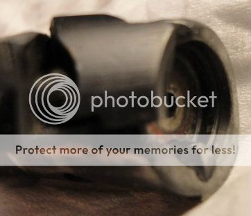

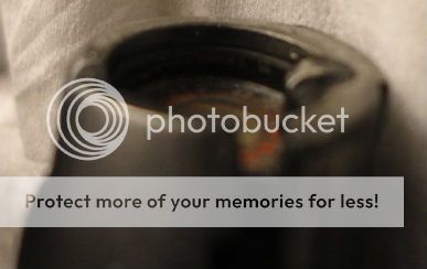

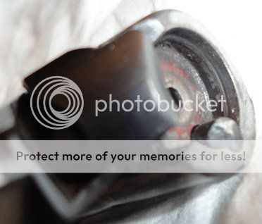

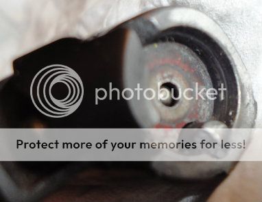

This old Winchester M1 Carbine has been experiencing some cycling issues. Which, IIRC was failure to eject. This has happened with several types of ammo. Take a look at the pics of the ejector, does it look worn/rounded? Secondly, in some pictures on the internet the ejector looks flat on the end, was there also sloped variation or is this really worn out? Should I replace the ejector or do you have any other ideas to get this running smoothly? The ejector and extractor springs both seem good. The extractor seems to work fine. The operating slide spring was recently replaced with a NOS one. The piston nut and piston were both replaced because the nut was damaged. I should mention that these parts were swapped in after the cycling problems and they haven't rectified them. It's been cleaned and lubricated. The three mags used were all USGI. Sorry for the picture quality. Any help would be appreciated because I'm running out of ideas. Thanks, VR
Hi Vimy, looks like your ejector has fatigued and a piece actually sheared off. It also looks like your extractor isn't sitting tight like mine in the bolt. Maybe it is just the way the photo makes it look but you definitely should install a new ejector and I'd have someone with carbine experience take a look at your bolt and extractor condition. Are you using commercial ammo or reloads? I have found all of my 3 carbines to be tempermental at best with moderate hand loads but when loaded to milspec all work as they should. VERY seldom do I ever have a misfed round and have hardly ever seen a failure to eject. Mild loads for me have produced rechambered or stovepiped fired cases and I've seen bad fitting or poor quality mags cause similar issues. Most of the commercial ammo I ran through my guns has worked very well, but I haven't used any of the more recent stuff to hit the market. All the commercial stuff I ever used was older production Remington and Winchester that I had for many years now, as I have been reloading for a long time. I checked and all my carbines have slightly rounded pins. They're fun guns to shoot. Hope you figure out what's happening with yours.

is that rust on the bolt face........
your rifle may be short strokeing the gas piston is it free does it move nicely??
they did do an upgrade on the gas piston nut to increase piston travel
Not rust, junk from the primers.

...looks like your ejector has fatigued and a piece actually sheared off. It also looks like your extractor isn't sitting tight like mine in the bolt. Maybe it is just the way the photo makes it look but you definitely should install a new ejector and I'd have someone with carbine experience take a look at your bolt and extractor condition. Are you using commercial ammo or reloads?
I believe the extractor just looks funny from the angle of the photos. The ejector works fine when I use an empty case. I'm only using factory ammo. Mostly Winchester and Remington stuff. Although I don't remember what kind of ammo had the red sealant around the primers. I may end up replacing the ejector and spring, it couldn't hurt.

looks like you need a new extractor spring. and possibly some wd-40 in the ejector.
I thought it was interesting that this keeps coming up. I re-examined the bolt. The spring pushes the extractor back, but the plunger doesn't stay up against the extractor once it's at rest. The extractor can move up and down slightly as a result. Good eyes gaff and goldidig.
