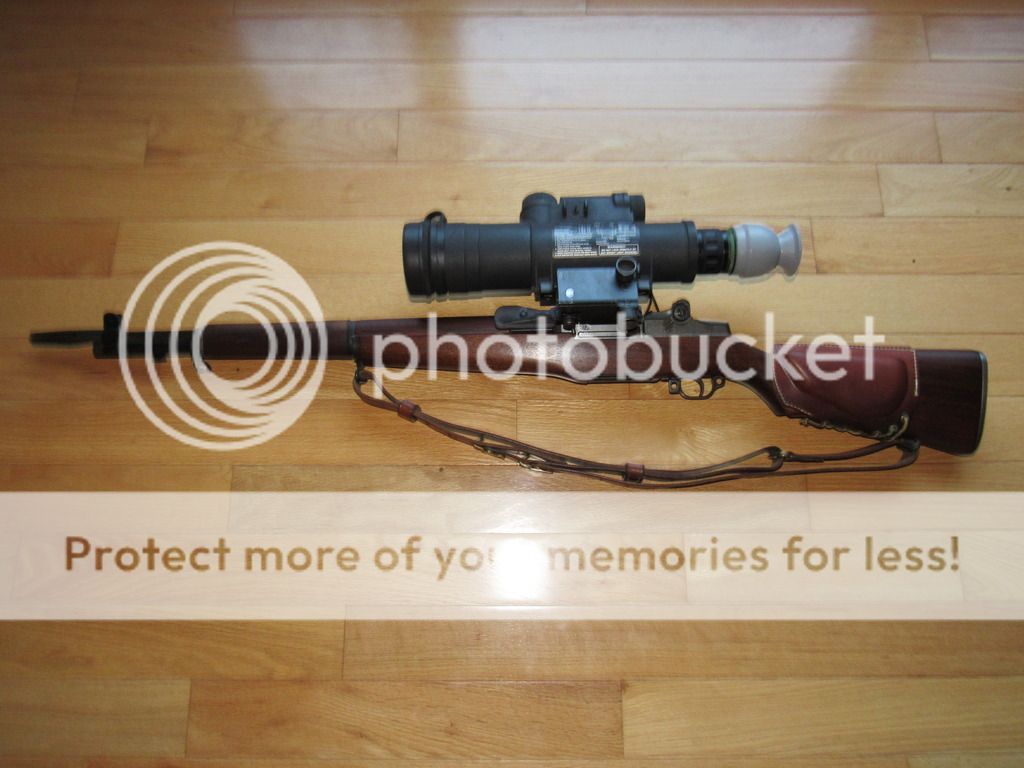

I've only seen one or two pictures of an M1C with an infra-red sight and they were not very clear to begin with. I understand that a number of years ago, a few rifles were floating around Canada with a welded(?) rail attached in the same position as the M-1C's rail. Do you have pictures or can you expand on its description? Its uncertain if this was a US modification or were they NATO partners who did the modification.

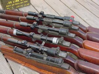

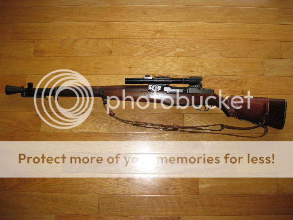

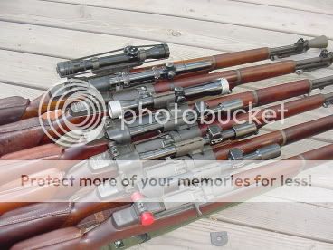

Below are a few pictures of some of my M1C and D rifles I've found over the years.
Regards,
Michael
The Garand receivers with the welded on brackets were a Danish modification for IR sight. There is a rail which is bolted to the brackets which serves as a mount dor the IR sight unit.
AFAIK the Danes only modified tbeir Beretta or Breda rifles for this purpose. I've owned a 2 digit Beretta with the welded on brackets and rail for 15-16 years and I've kept it with the hope of locating one of the IR sight units.
The welded on brackets don't look very elegant, but they obviously got the job done.
