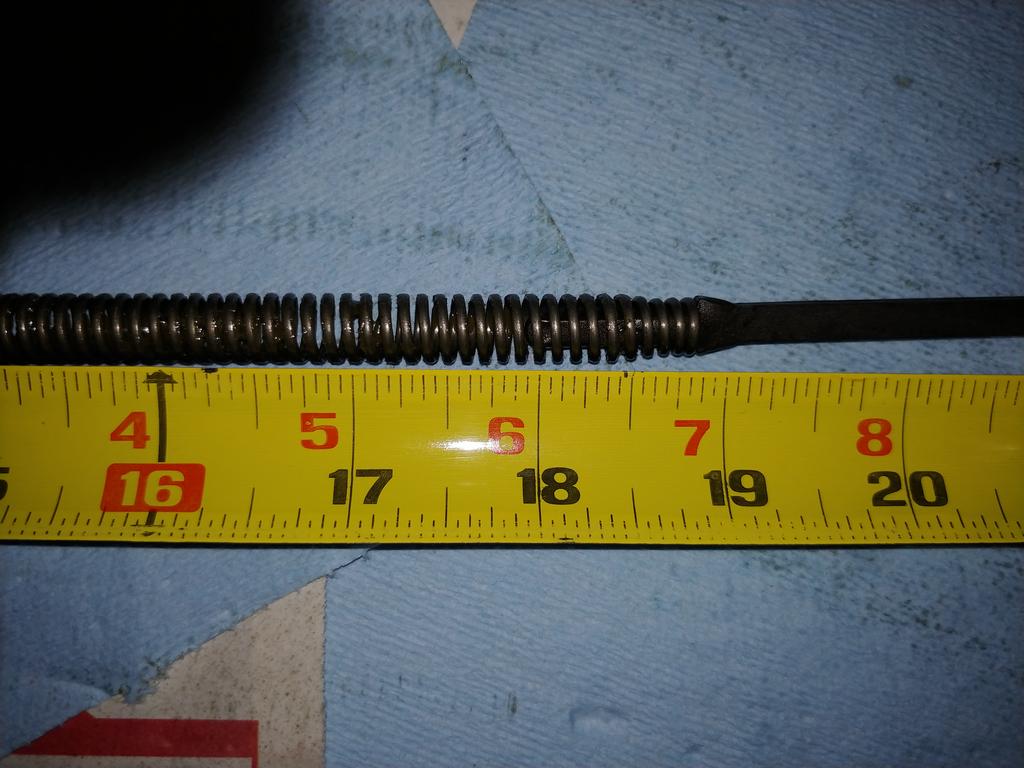

I cut off a couple of coils worth of spring and a lil more. Unfortunately it's still binding on the 8th round. Thoughts?
The recoil spring is at this length now after its been cut.

My spring started at 19.5" and I took .5" off. The action still felt a little firm but it would take clips.
Jager mentioned his original .308 spring was 17.75" but would not cycle reliably so he got a longer spring. Perhaps trim a little more until it works. If everything else is correctly assembled it should work. Worst case, springs are cheap.
Yes the overall length of the spring will vary slightly depending on the thickness of the spring material itself. Thinner material would permit a longer uncompressed OAL, all other things being equal. Did you test to see if the gun would accept full clips with the main spring removed?
