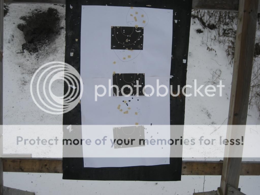

Can you shoot off a bench at 50 to 100 yards and shoot a decent group? If so, try some other loads and see if group is noticeably better.
I would load 5 of each, in 0.5 gr increments, from 44 to 47 gr. Shoot off sandbags, and let barrel cool between 5 shot groups. Make sure you have a good aiming mark. I use rectangular black aiming marks stapled to a paper backer.

I use a target similar to Ganderite's. Make the aiming rectangle 7inches wide and sit the front post at 6 o'clock.
