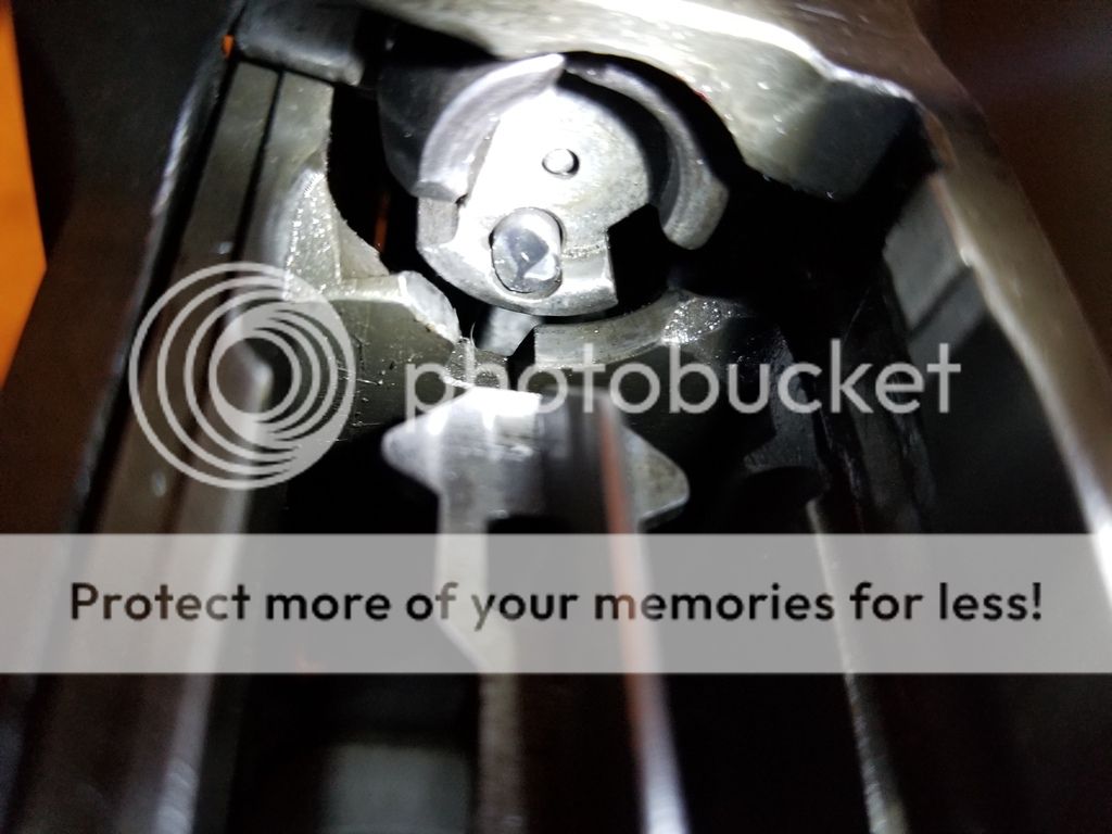

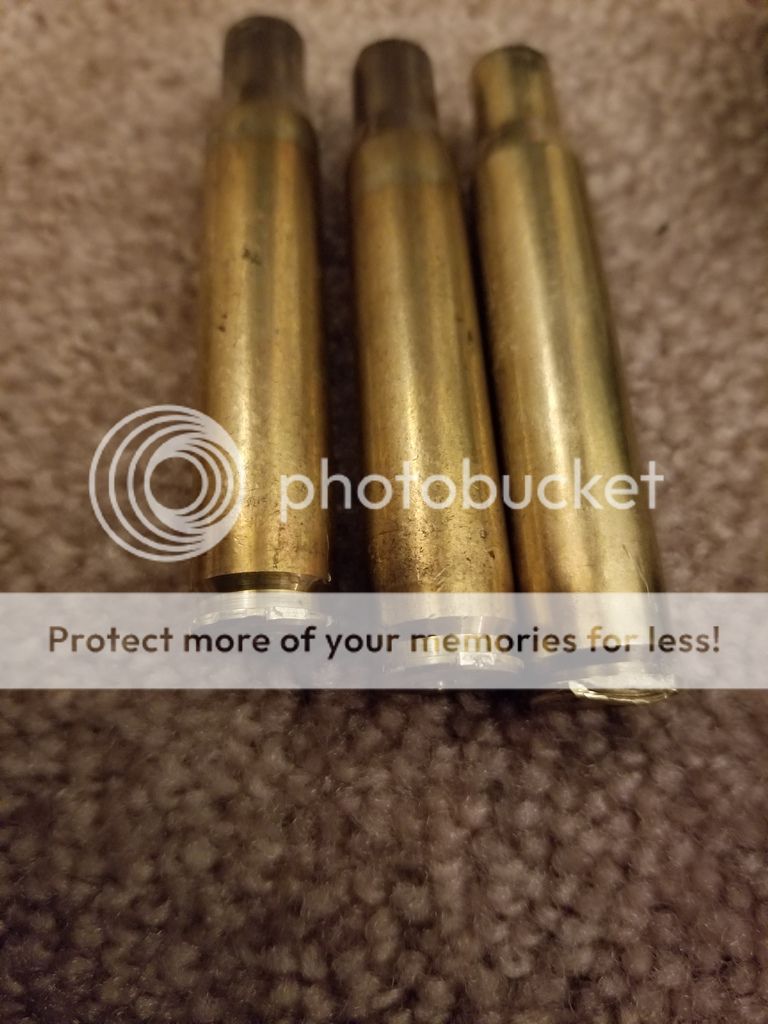

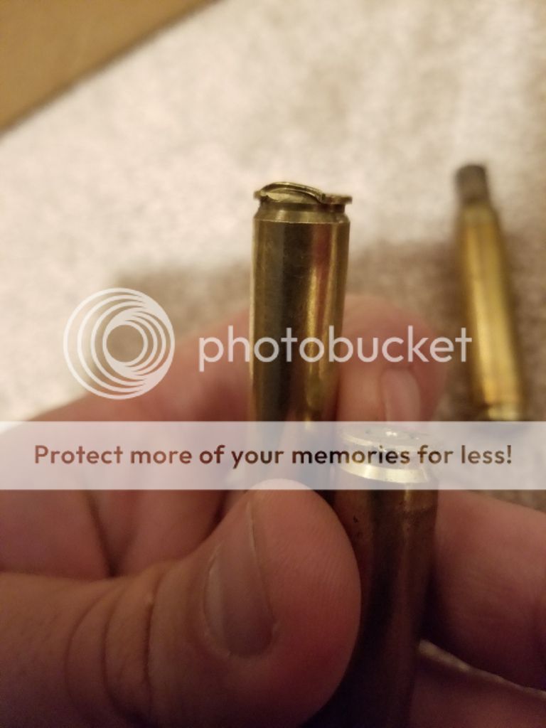

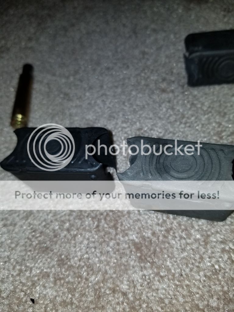

I tried multiple types of en bloc clips, and have included pictures. upon the second round being fired the gun would jam the extractor would rip the top of the brass as it came back and then the casing would be stuck in the chamber. I would have to put a cleaning rod down the front the push it back into the magazine well. When i single loaded just 1 round at a time the gun would work fine. Both ammo seemed to have this issue, at one point the clip ejected with 2 rounds remaining.

I have some more idea's on how I am going to troubleshoot as well. (trying and marking different enbloc clips etc.

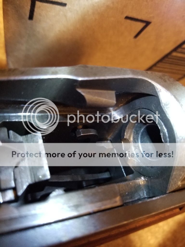

I don't know if the pictures help anyone in my diagnosis but i appreciate any insight. I will also try to maybe goto a gunsmith in town and see what they have to say.
in the picture of the 3 rounds the far right is the federal the other two are greek, but even though it seems to tear the federal more, both would still sometimes get stuck in the chamber.
