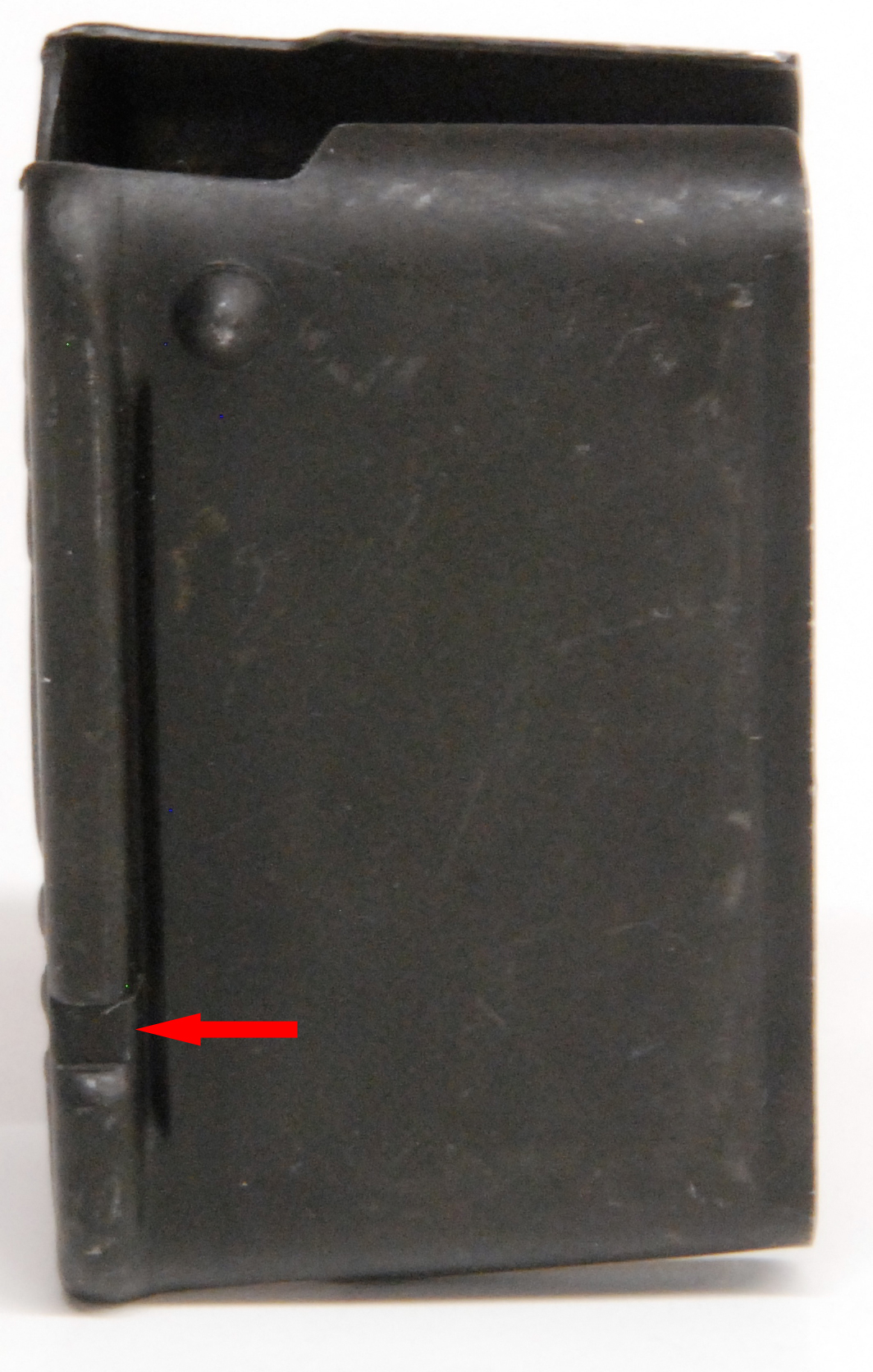

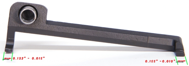

I have a new op rod spring inbound. I'm not sure it's the problem however as the rifle does it's ejection even when manually cycling dummy rounds. For that reason I also have a new clip latch and a few different en-bloc clips en route too. Hopefully I can solve this problem by tossing in these new parts
Well I received my bag of parts from Numrich a few days back. I replaced the clip latch and the guide rod (the guide rod didn't look any different, but since I had it all apart anyways). I didn't replace any of the springs, and as mentioned by another member the Wolff main spring is much too long since it is probably for a 30-06 action and mine is 7.62. The new en-blocs have LOTS of coating on them and they won't even fit in the action; I plan to get someone with a reloading tumbler to spin them around overnight next weekend.
