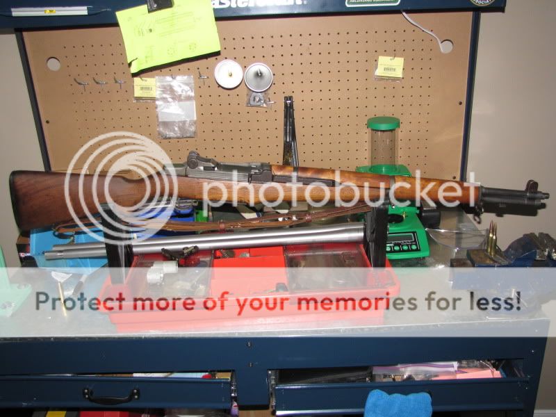

Thanks to all who has replied to this thread. Here are some pictures of the rifle.

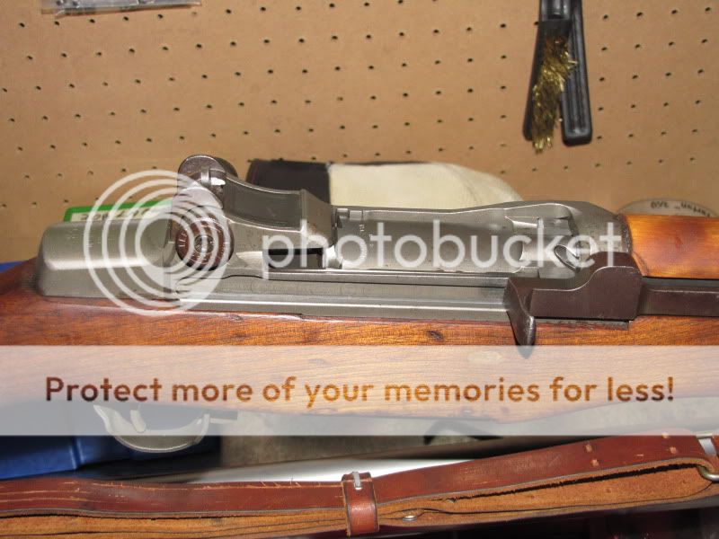

Complete full view of rifle.
Close up of right side of receiver

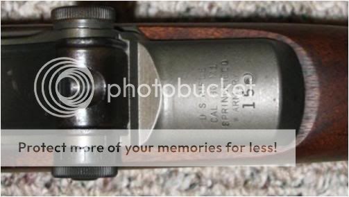

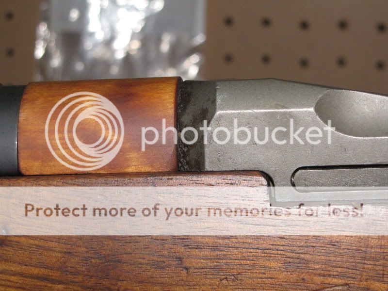

Top view of receiver. There is pitting around the front of the receiver where the barrel meets the action.

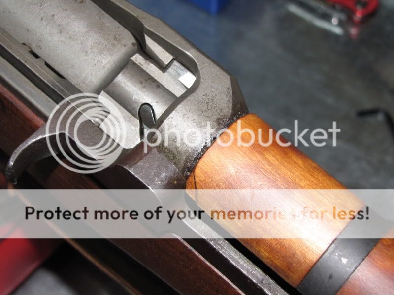

Close up of pitting around receiver

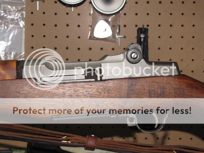

Left side of receiver and stock. The stock has SA-EMeF stamp.

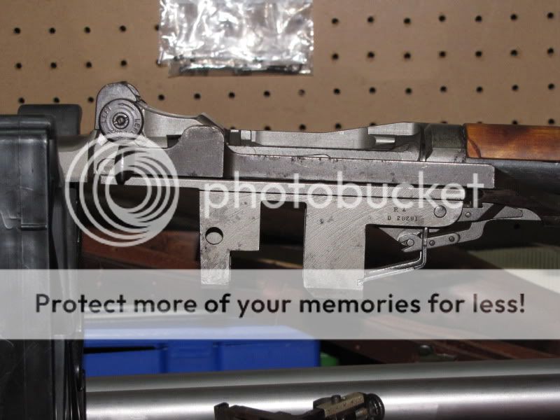

Close up of receiver when stock is removed

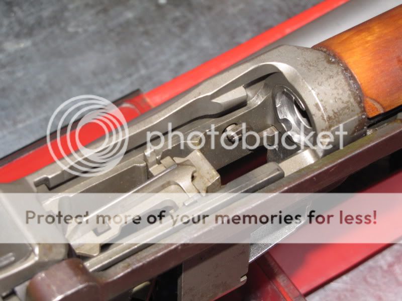

Close up of receiver when bolt is back. You can see rebuild weld on the follower assembly

This is a very early receiver which was re-built with a lot of later replacement parts. We don't see/have any barrel details, but the cartouched stock itself is worth some money.
The face of the receiver is badly pitted. Generally rifles are not re-built when the face is pitted to this extent as the pitting does not provide a good surface for the even, concentric crush fit which is desired when fitting a barrel. Beyond that, this detracts from the appearance of the rifle. I wouldn't do a build on this receiver w/o a very close look at the condition of the receiver face which bears against the barrel shoulder. If it was a no-go condition, the receiver could be removed and conserved as an interesting piece of history with the other parts being used to build a rifle on a more servicable receiver.
It's tough to put a value on the receiver alone. It depends on who may have an interest in it as a collector's piece. The stock dates from the mid-1942 to mid-1943 timeframe and would be desirable to restore a rifle of that vintage. If could fetch $200+ on it's own. The other parts, less barrel, would cost maybe $400. Barrel value depends on make/date and condition.
