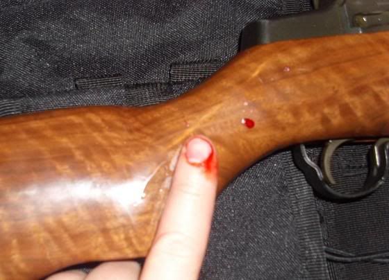

When cleaning your Garand if you get anywhere near the follower, make sure you are holding the bolt back tightly.
Here is my finger after not following my own advice. I lost my fingernail over this one.
