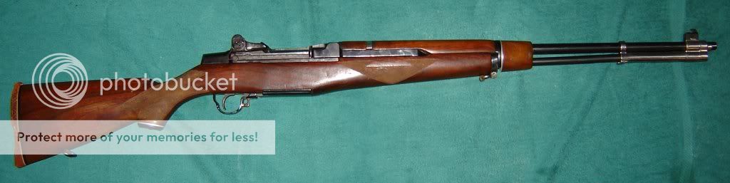

Ok guys, don't kill me if I have this in the wrong sub-forum ... I don't know what I have and couldn't figure if this shoudl be in Milsurp or in here ... :)
I have 2 M1's sitting here:
Serial # 161###x (1.6 million) - Marked Winchester at rear of action
It is very "clean" and everything has a good luster to it.
Serial # 226###x (2.2 million) - marked Springfield Armory at rear of action
The wood on top, just in front of the reciever looks to have been replaced (doesn't match rest of wood on gun) - and the replacement piece has had some rectangular holes in it filled with small pieces of wood.
This thing is as rough/ugly as it look in the pic ... not "rusty" but it certainly has all it's orignal patina
Both guns have the same rear sight - dial on left for left right adjustments, dial on right for vertical adjustments. edit: Winchester has V-Groove rear sight, Springfiled has Peep-style rear sight.

Well, considering most of the front handguard is missing on the top one, that will decrease the value of it somewhat. It also kind of looks like some wood is missing on the stock. For that reason the 2nd one is probably more desirable, unless you want to get a replacement handguard and stock. I'm no expert, but given the condition from what I can see in the pictures they might go for $700-800ish (maybe more since they are from '43, maybe less if the internal parts aren't in very good condition). Others with more experience with these are probably a better judge than me though.

"...front handguard is missing on the top one..." It's a commercial 'sporter' stock. The rifle has been blued, likely cold bluing. The finish has been removed from the gas tube and the front sight is aftermarket. Value is about half of a non-bubba'd rifle.
"...Winchester has V-Groove..." Most likely a sight that was cut or replaced by whoever sporterized it. Not difficult nor terribly expensive to put original sights on.
Unless you want to take the time and spend the money, it'd be the one to sell.
Second one is in original configuration. Worth more than the first, even though the condition is a bit rough(not horrible though. Finish is mostly gone. Clean the stock and look closely at the barrel.

The top one is a shooter, but with the correct wood could be brought back to the appearance it had when it was carried in the war.
