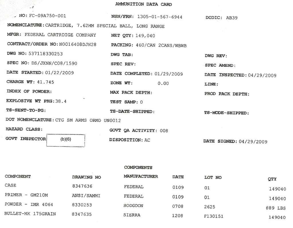

I known US 175gr SMK LOAD the MK 316 MOD 0 uses 41.745gr of IMR4064.

Here is the load data from the current batch of 118 ammo:
