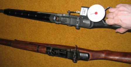

Anyway, I did some measuring (see the last picture at the above link for what I'm doing) ...
M14/305b, hammer back/cocked
0.5": 12 pounds
1": 12 pounds
2": 16 pounds
M14/305b, hammer forward
0.5": 23 pounds
1": 35 pounds !!!
2": 16 pounds
M1 Garand, hammer back/cocked
0.5": 12 pounds
1": 20 pounds
2": 20 pounds
M1 Garand, hammer forward
0.5": 23 pounds
1": 28 pounds
2": 20 pounds
I haven't taken the M14/305b to the range yet. I'm worried that it's unsafe.
The M1 Garand cycles fine at the range.
Are these tensions normal?
0.5": 12 pounds
1": 12 pounds
2": 16 pounds
0.5": 23 pounds
1": 35 pounds !!!
2": 16 pounds
0.5": 12 pounds
1": 20 pounds
2": 20 pounds
0.5": 23 pounds
1": 28 pounds
2": 20 pounds
