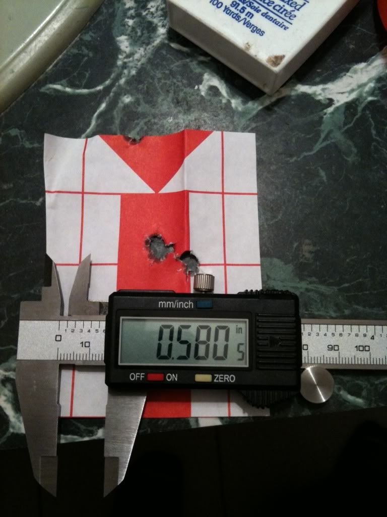

Finally got out and did some shooting.
Hand loaded 3 batches, each using a 150gr Hornady bulk bullet, CCI primer and new Winchester 308 commercial brass. All cases were neck sized.
Shooting was done at 50yrds.
200 rounds were put through her the prior day for a sight in.
Rifle is stock with iron sights except for a USGI spring, Sadlak guide, Sadlak piston @ Harris Bi Pod.
The three loads were 4064 (use it for my 150gr 30-30 loads) 4895 & 8208 XBR (use it for my 160FTX 30-30 loads)
Note: when I say 1.25 inch grouping I measure from edge to edge not middle to middle.
1) 4064 @ 44gr - Average results, grouping at 1.25 inch. Cases were 2.005 before and between 2.010 and 2.015 after. This was a slightly compressed load even at 44 gr, you could hear the powder compressing when you seated the bullet. Light compression, but compression none the less.
2) 4895 @ 42gr - Little better, grouping at .5 inch. Cases were 2.005 before and between 2.007 and 2.012 after. No compression, the power was slightly finer than the 4064.
3) 8208 XBR @ 42gr - VERY tight grouping at .25 - .5 inch, some were going through existing holes. Most impressed and surprised. Cases were 2.005 before and between 2.010 and 2.015 after. No compression, the powder is almost like sand and there was plenty of space. Shaking the bullet after loading you can hear the powder sloshing around.
What struck me the most after just the 1st round was the increased recoil, snap and sound. It felt like a significantly harder load but the rifle seemed to love it. Also seemed to fire out the brass quicker and sharper.
I have a few hundred of each load left over so I will go out to 100 yrd next week and see what happens.
Will also swap out the gas piston for the stocker and do a comparison.
I plan on taking one batch of fired brass and neck sizing only to see what the case stretch is after a second firing and also if the accuracy is affected.
So there you have it, may not be right for your rifle but the 8208 was very impressive.
I'll update next week after 100yrds and again after I've fired the first batch of neck sized once fired brass.

Remember how I was saying 43 grains of H4895 over a Prvi 150 grn FMJ works really well? :D
100 yards, iron sights, bipod w/sand bag in the back....
Well, you're right. After moving out to 100 & 200 yrds the 8208 QUICKLY got shot down.
No good......at all.
It was 4895 by a long shot.
