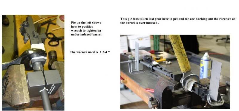

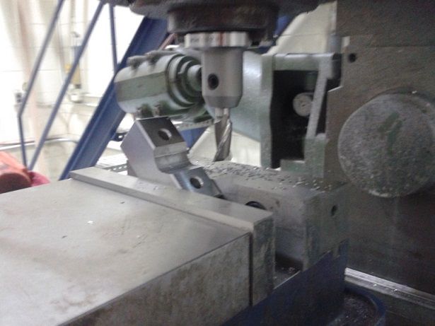

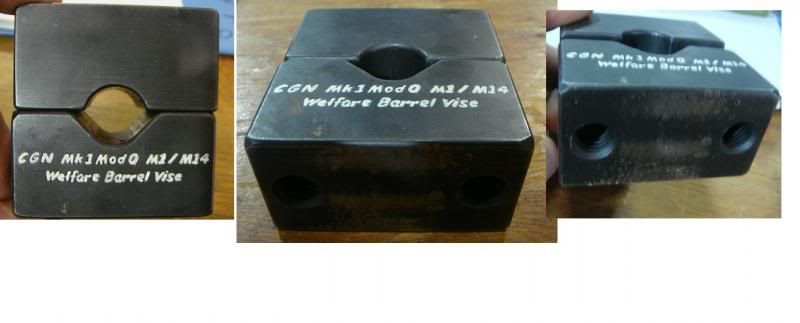

Pics are from some of Tactical Teachers clinics and shows how to place the wrench on the receiver to tighten and loosen the barrel. As well it shows how to set up the indicators to index the barrel correctly. I had a copy made on a milling machine of Barneys famous " Welfare Barrel Vise " for myself . The vise has to fit on the beveled section of the barrel so the 2 halves of the vise are shaped different .
I set up the vise with the 2 different blocks just like in your photo. They are solid oak and compressed to fit extremely tight. I have a 3 foot bar, heated the receiver and used penetrating oil (again) and rapped it with a 2 pound sledge with no result other than it chewing the oak! I'm probably just going to carefully relieve and split the stub. I did a garand a while ago and it wasn't nearly like this.
