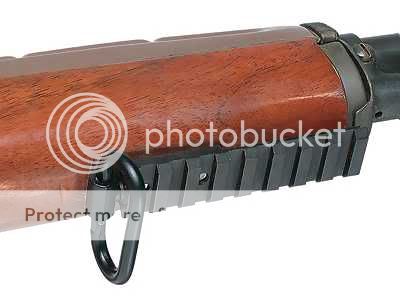

Instead of doing all that drilling you could try something like the "stock front swivel replacement with rail" found at http://www.fulton-armory.com/MAParts.htm
I dont know if they ship to canada but it would make the bipod mounting easy to the rail and you could still use your sling. Or you could just get a USGI synthetic and remove the swivel and attach a bipod. There are instructions on how to do this in the battle riffles section i think. If you just drilled it yourself, like you were suggesting, it would likely hold as well i think...ive never seen it done.
Best thing to do (IMHO) is to buy a harris adapter for an AR15. Get rid of the sling swivel that currently sits on the front, then simply inlet the inside of the stock to recess the AR adapter so it doesn't interfere with the op-rod. Fill it with epoxy, and you've got a SOLID mounting point for the bipod.
It's too bad that Fulton won't sell to Canada, as these little babies work great I just sold an extra one yesterday.
IMHO they are the fastest and easiest way to get the job done on a wood or GI FG stock. You just drill out the rivits, remove old metal, screw the new one in.....no inleting, epoxy. If you have a bi-pod with a 1913 mount like the GG&G or the Smith Ent. these are the ticket but with Harris you'd have to buy that stupid 1913 adapter.......with costs more that this little rail/sling.
