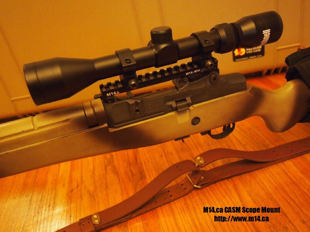

Tony, it is clear to me that you have over-torqued the scope mount. The installation instructions, specifically Note 3's implications are unambiguous. If the mount is flexing as it is in the photo you took my friend, it is time to re-evaluate the installation. Please review and follow the installation instructions in greater detail for the CASM scope mount and let me know how it turns out for you. I hope the email I have already sent you in response to this has been helpful. Take a look at these four examples of a correct installation:
I eased off on the rear vertical screw and reset it with blue locktite (see attached). I think it is fair to say I overtightened that screw and did not apply the same principles to the rear screw that I did to the front screw--1/8-1/4 turn. The result is a much straighter Casm mount.
