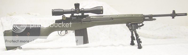

Since I can't leave well enough alone I have decided to Cerakote a rifle. The problem is I can't decide on a colour scheme. Looking for suggestions from all of you. I have on hand;
Socom Blue
Graphite black
Coyote Tan
OD Green
Burnt bronze
tactical grey
Titanium
Any suggestions?

Right now I am leaning towards going socom blue on the steel since I have not yet tried that colour and od green on the stock. But tactical grey steel is appealing too.

Going to do socom blue cerakote on the steel and either od green or tan krylon on the stock. Will try to get pictures up tonight. just going to spray the steel in a few minutes.
