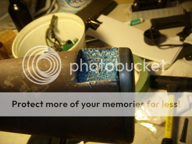

ARMS 18 Set Screw
* Replaces the set screw Allen head for the front contact pad
* No more having to grind/dremel your handguard :eek:
* Low profile and stays hidden
* if you have an ARMS18 scope mount, this is for you... FREE
