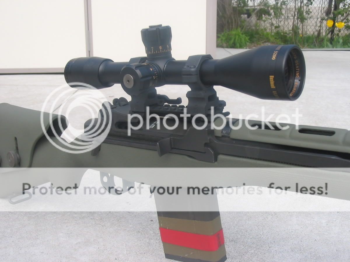

What I have done so far.
-TRW bolt
-TRW trigger group
-TRW op rod
-rooster33 spring guide
-rooster33 bolt release
-rooster33 cheek rest
-shims
-ARMS scope mount
-ARMS rings
-fake Full auto switch
-bipod
-3200 mil dot scope
But with all the pics going around lately of the shorty M14's I think I'm going to make some changes.
M14S are fun :)
M21 style rifle:
USGI Sythetic stock
R33 tactical latch
R33 op rod guide
TSA scope mount
Smiths rings w/ 1" inserts
6X9 optics
Harris type bipod
OD Green drag mat and extra mags :)
alot of OD paint .....:)
