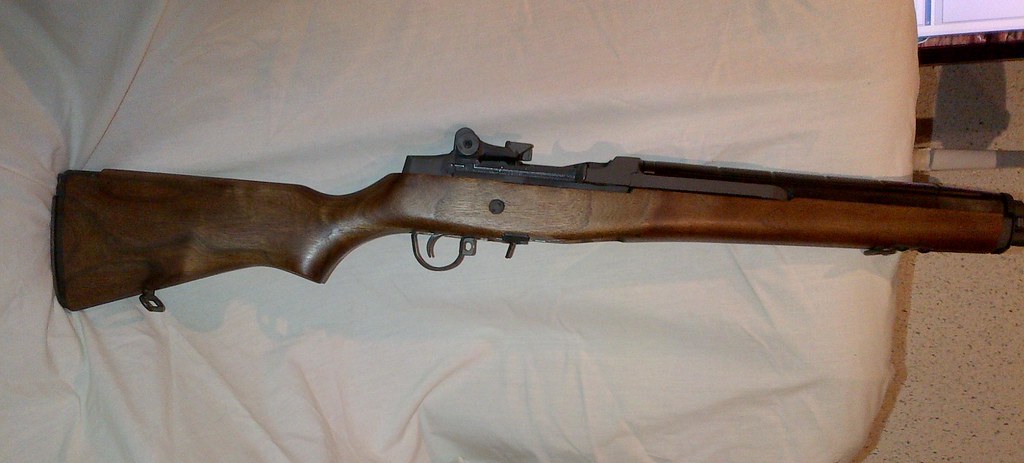

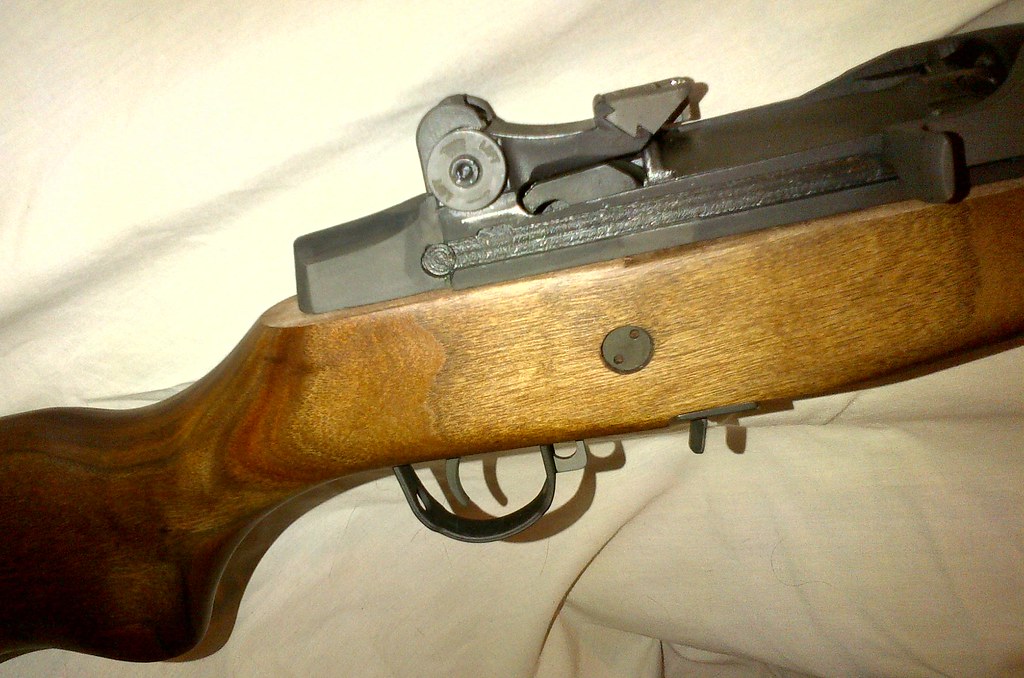

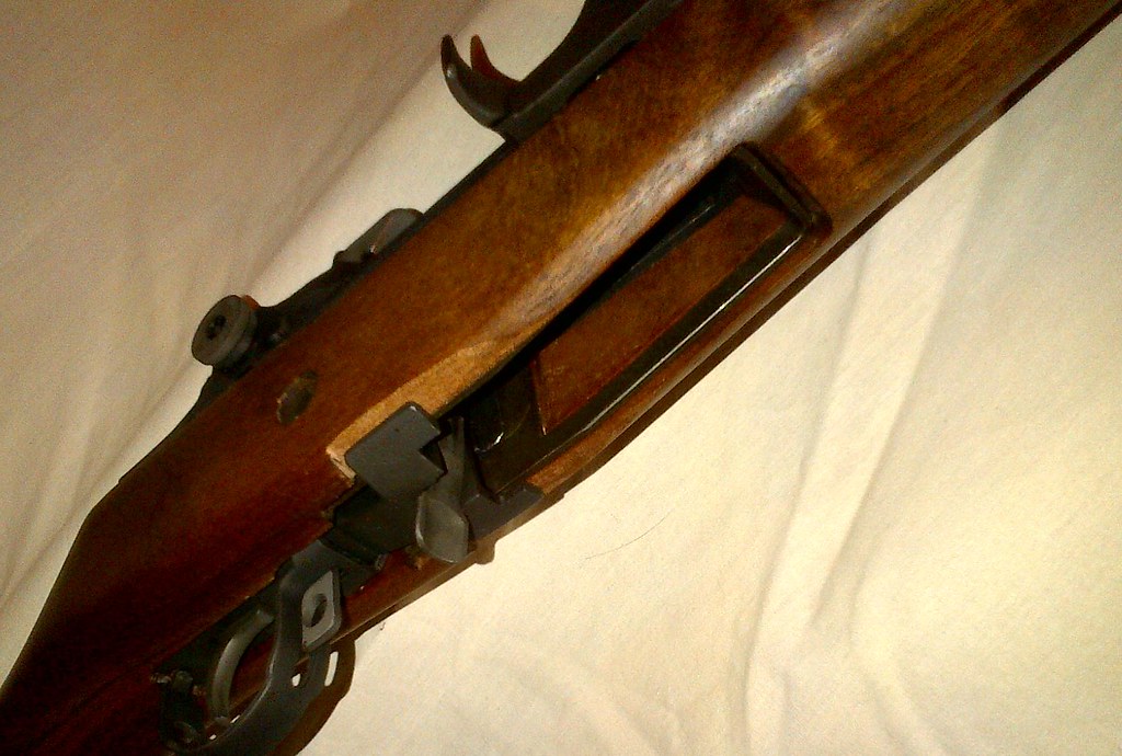

And for those of you that insist on pictures....
[sigh] Now I have to take it apart again to clean up any leftover roughness and refinish the stock...but it's ALIIIIIVE!!! Look out zombies!
