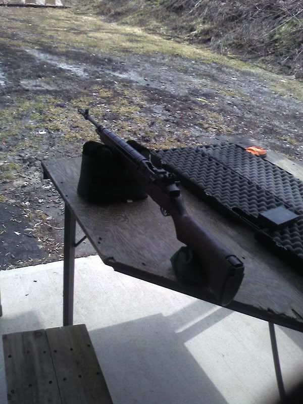

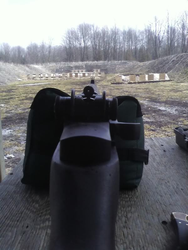

So I drive out to EESA with some 7.62 IVI Ball. Looking forward to sighting in this stock Norc M14 from Dark Int.
http://i69.photobucket.com/albums/i75/slushee1234/SSPX0050-1.jpg
http://i69.photobucket.com/albums/i75/slushee1234/SSPX0051-1.jpg
http://i69.photobucket.com/albums/i75/slushee1234/SSPX0052-1.jpg

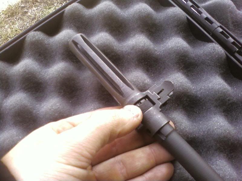

You can see how the first two shots were GREAT! even better then before. But after that ... I just couldn't get why my accuracy went to h3ll. Then I started packing up and noticed my flash hider had come loose (which the front sight sits upon).... Because Dark Int. replaced it, it is NOT welded and the wheel rotated a bit (the set screw stopped it from rotating so much that it would have fallen off, but it was still wiggling about 1-2mm)
http://i69.photobucket.com/albums/i75/slushee1234/SSPX0053-1.jpg
Think I found the culperate? I think so ... problem is I dont have the tool to tighten it! Oh well, at least I know how good it CAN shoot
