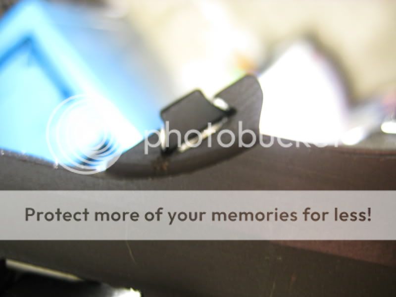

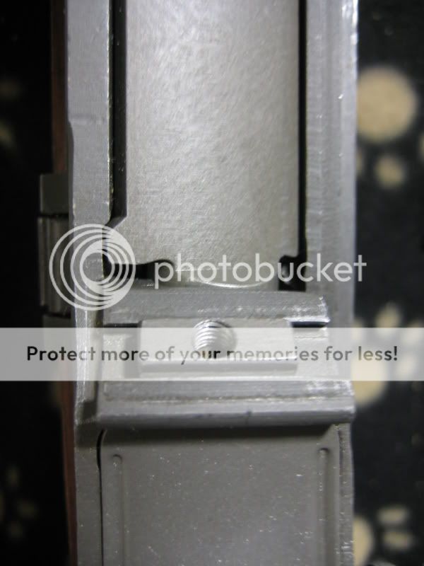

I am attempting to install a Smith 2014 mount. After finally getting the stripper clip guide out (I had to hit quite hard with a hammer), I'm having difficulty getting the dovetail from the smith mount to go back in. The stripper clip grooves just seem too small.
Has anyone else had this problem?

Yeah I tried both sides. I started with the left side (when looking straight down at the gun with it facing away from you) as this is the side that the stripper clip came out of.
Now I'm trying a little diamond grit sand paper on the mount's dovetail to see if i can get it to go. A file just seems a little destructive.

Well I sanded the sh@t out of the dovetail and managed to wedge it in there. It doesn't exactly "move freely" like the instructions from Smith say it should. I don't have a boresighter, so I have no idea where it's pointing...seems kind of straight. We shall have to see.
Is your mount a Smith mount -god-? If this is the case, I'm guessing there must be some variance in the size of this dovetail groove amongst the norcs?
