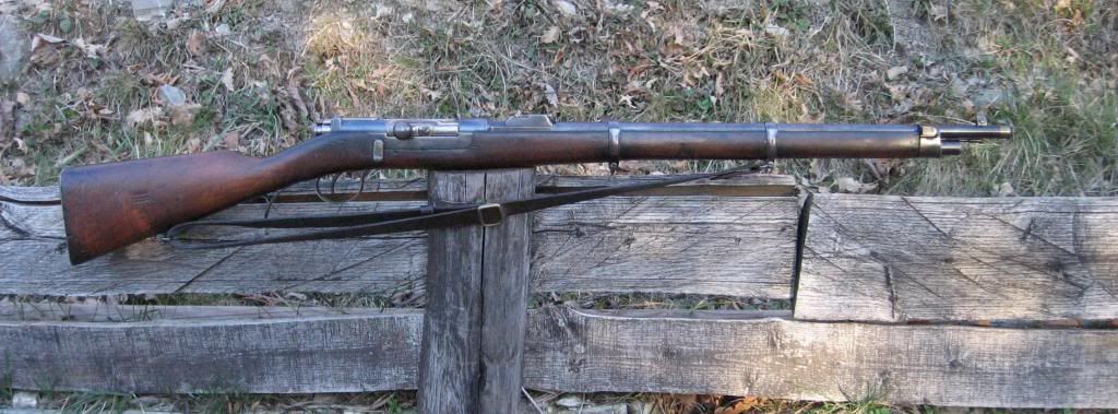

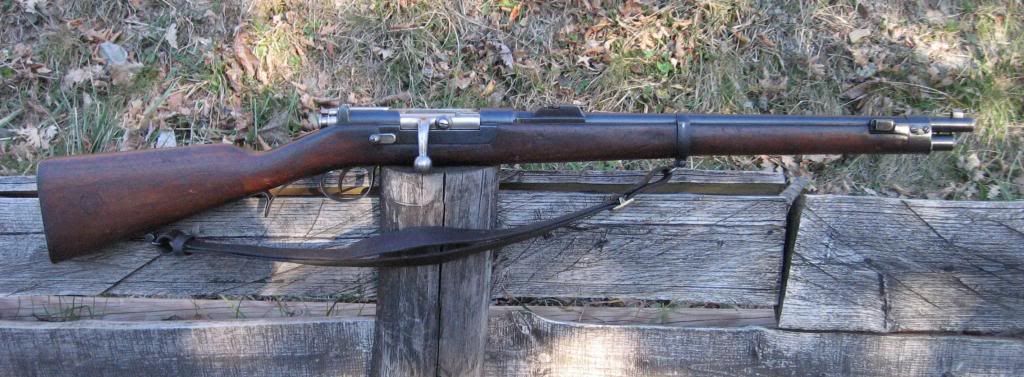

I got a couple of rifles from an estate that I am looking for information on. Does anybody load and shoot for these rifles?
I have two: one is the quite common Infantry Rifle (P&S Militaria has some), but I also have the Carbine which I understand is quite a bit rarer. These are really outside my collecting interest, so I'm considering selling but I can't find much information about them.
Mine are the ones like on the top and the bottom of this picture I found on the internet.
PS I have two LONG bayonets as well for them.

I wonder why the carbine has a turned down bolt handle?
Hey Pete, the turned down bolt handle was for making them handier on horseback. Very common for carbines of that age. By mid WWI the Germans were bending the bolts on their Karabiners as well like my Kar98az
