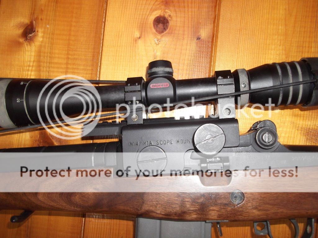

If your on a budget, or just cheap like me, you could get one of these.
I think its a Nc Star or Promag, solid steel, but it cost about 35 bucks and has never caused a stovepipe or lost zero ( except when I fart around with it )
And you can use the irons with the scope on :)
Yeah, I know the rings are massive, but they work for me.
Arms 18's are cool but they cause stovepipes with Chinese springs that necessitate a spring swap for usgi.

Really cool "Lost-Again". Re: NC Star Mount.
I like how this model allows for the iron sights. I'm looking into it.
Does the NC Star Mount come with BOTH thumb screws? Online it only shows ONE. Also, some posts mention this particular mount requires some adjustments to get it mounted right for the M305.
Pat :eek:)
I cant say if the mount comes with two thumbscrews now, but mine definitely did a couple of years ago.
As for Nc Star... well lets just say they are well known for being an "inferior product", and mostly I would advise to stay away from the brand.
In this case tho, we are talking about a single piece of steel, and not even a safety issue.
The mount comes with an adjustable thumbscrew at the rear and , which I find very useful as it allows for lateral adjustment without adjusting the scope.
It mounts very solidly into the stripper clip guide, and will hold zero.
I have had no problems using different rings and scopes on this mount, tho I would advise using blue Loctite...the recoil will shake stuff loose no matter which brand you use.
And yes you can look under the scope and get a very good sight picture.
A few people will chime in and say its Chinese crap and to stay away from it.
Truth be told, there are a few people using this mount and what the hell.............its a Chinese mount for a Chinese gun.
There are quite a few threads about all these fancy mounts not fitting and need shims etc.
It works for me VERY well and the price is unbelievable.
Keepin it cheap is way more fun
Cheers
Derek.
