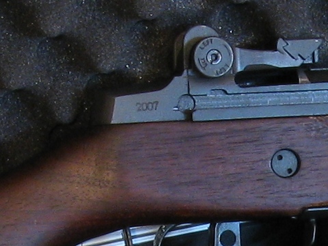

In the past we have consulted with Lee Emerson (cgn member 'different') on dating m14 receivers and the numbers under the stock line on the left side of the receiver are the numbers used.
