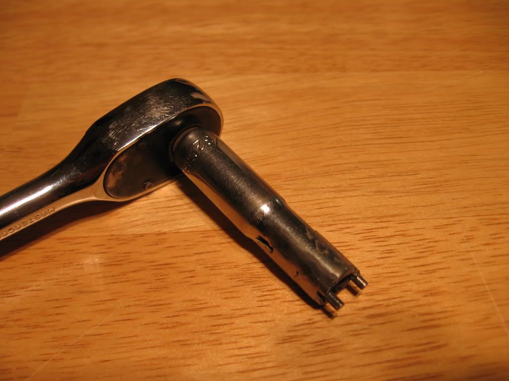

Working on guns is so much more challenging that heavy equipment, at least off highway equipment takes all the same tools. Every time I start a gun project I find myself in the garage making jigs and tooling more than doing the work on the gun!
My latest Frankenstein from my collection of extra tools, damn stock retainer bolts are hard to remove!
