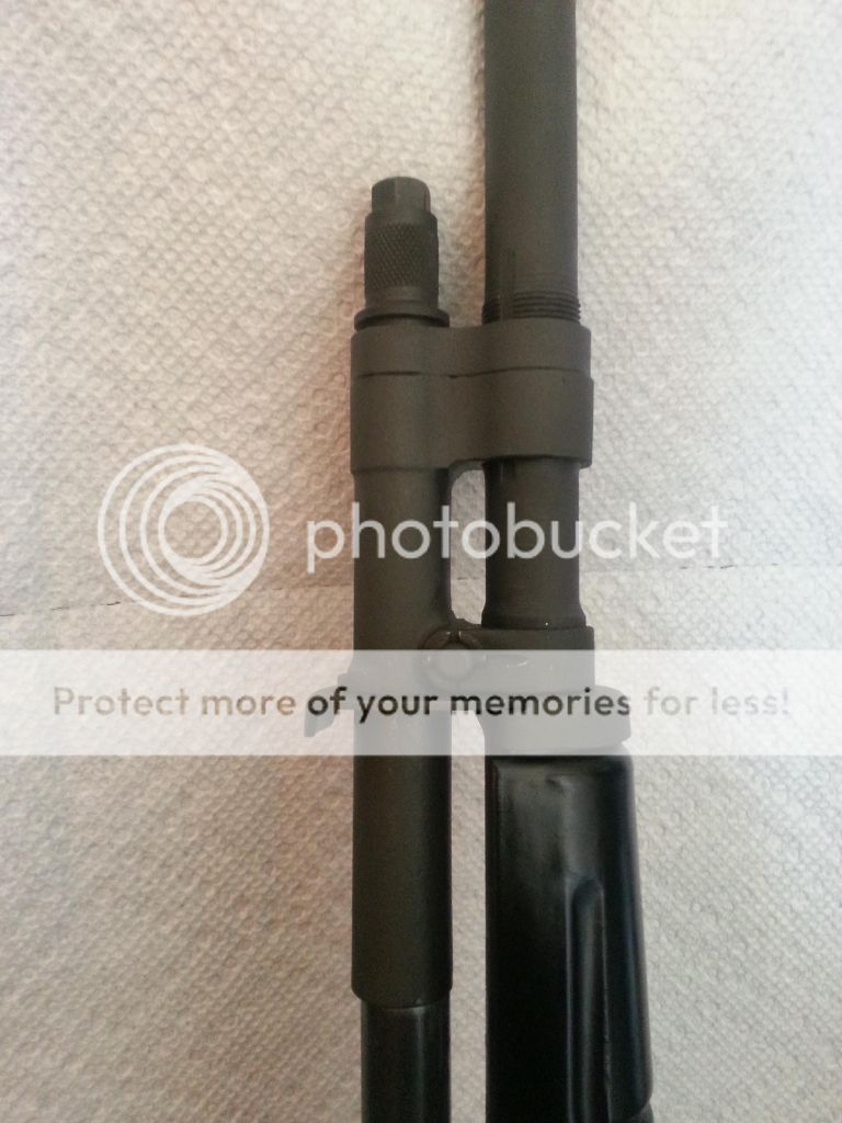

In order to cycle correctly this is where the op rod and piston need to be. Notice the plug isn't threaded all the way down. Any more and it pushes the piston out into the op rod.

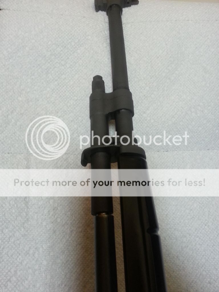

Here you can see the piston and op rod when the plug is fully tightened.

The plug might be too long, when you thread it all the way in, it pushes the piston out almost an 1'8th inch against the op rod.

Everything you are stating about lengths is correct on yours. My gas plug pushes the piston out by that exact same amount. If you very seriously think that the gas port in the barrel and the gas acceptance hole in the piston don't line up MY OPINION OF the solution is to elongate the piston gas acceptance hole until it matches.

When it doesn't cycle, the op rod doesn't even wiggle. Otherwise it cycles fine. But it is definitely not reliable. The gas piston doesn't just drop in, it doesn't take a lot of force, but it has to be pushed through lightly until it comes out about half inch on the op rod side then it moves freely. It has gotten better since I have been polishing it a bit. Will keep working on it. If that doesn't fix it, I might have to resort to elongating the hole in the piston a bit to ensure the gas is getting in.
Don't mess with piston , you might need to shim the gas system a bit . Remove the piston and slide a drill bit through the gas relief hole it should go into the barrel. If not you may need to shim.
I polished slowly until I could slide piston in with little force. The hole into the barrel seems fine. Going to go try it out after lunch hopefully
