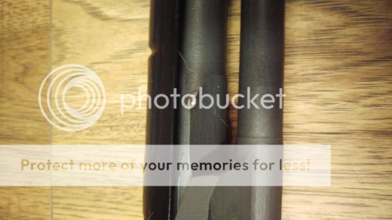

Hello im having a little issue with a norinco m305 and iv kind of run out of ideas. When the rifle is fired the op rod hits the right side of the chamber where it tapers down. Not just a rub, a full out contact leaving dents. When the op rod is moved by hand with or without the spring the op rod is nowhere near the contact point and moves freely and smoothly. My op rod guide is knurled and epoxied in place, my barrel has been indexed, my gas piston appears to hit the op rod square and I have an aftermarket solid spring guide in place. I bought the gun used but unfired and unmodified and it has done this since than. Any help or ideas would be greatly appreciated. Thanks in advance. I know pictures are worth a thousand words but im having trouble posting them.

That's the conclusion I came down to as well but I can't figure out the cause. Everything appears to be square and not worn. As for the dents its on the barrel. Where the op rod seem to typically rub on the right side of the chamber but right where the barrel starts to taper down to the smaller profile it hits. I wish I could figure out pictures on here. I can send them privately through email if anyone thinks it will help.

I got it unfired and from the first shot it started doing that. First thing I tried to fix the problem was have the barrel indexed than i sharpied over the mark to see if it still happened and it did. Next I knurled under the op rod guide, set the op rod square and epoxied the guide in place, sharpied it again and tried again. Same problem. Than I purchased an aftermarket guide and spring unfortunately still no fix. To be completely honest I can't remember if the mark was there even when it was new in boxI just remember noticing it after the first time I fired it

See the "nub" on this op rod on the far left?
Is that nub or the channel on the receiver it fits into worn? Allowing lots of roll?
I'm still concerned about an excessive "roll" in the op rod. :confused:
