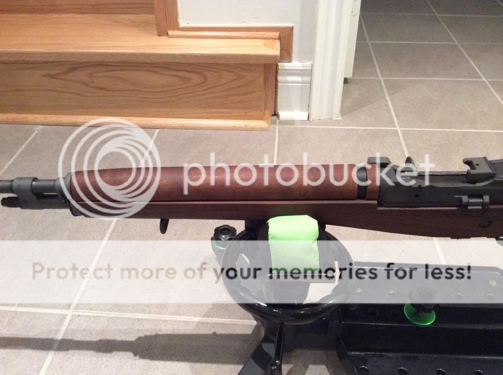

We'll have to have a "Wood Off!" I am doing up mine this weekend as well. These should come up absolutely beautiful with some sanding/oiling. I remember when I did up my 22" barreled Norc with a new, very plain, boyd's walnut stock how amazing it made it. The stain on the boyd's ones seems to cover up a lot of the grain in the wood and almost covers it like paint! I am thinking that the stain on these looks exactly that way too, but because there is such nice wood grain to start, it still shows through that heavy stain anyway. I'm thinking it will come out so nice that I won't want to take it out of the house after some sanding!
One thing I will have to address, that I noticed, on my stock is that the "U" channel at the front of the stock is a bit under sized and actually rubs on the gas cylinder when you put the stock on the rifle. I will fix that and give it some room with a dowel and sandpaper. The front flash hider was typically spot welded on and it took some effort to get it off. I have a new USGI one and front sight to replace that one now. The flash hider was typically not made very well and canted the front sight to the right.

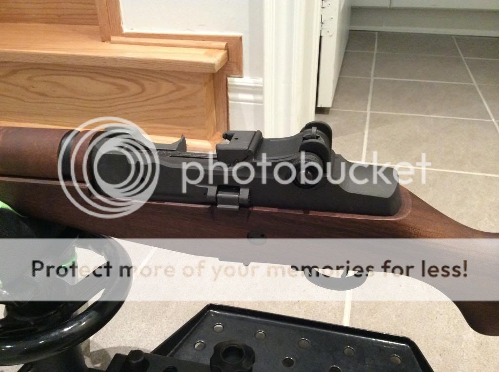

The barrel indexing looks to be good using the "drill bit in the gas hole on the barrel and looking through the receiver legs trick"! The rear sight actually seems to be good to go as well! My first one was completely buggered!
The Op Rod guide on the barrel was centered properly and peened tight which is also a good improvement over my first one.
The flash hider was not tightening up with the gas lock properly and I could hand tighten it past 7 O clock even with reversing the gas lock. I have shims that I will use for my new flash hider if needed and will try to get it to snug up at about 4 O clock and really tight at 6.
I will also put a new USGI sized OP Rod spring on it and an upgraded spring guide and will see how it shoots.
This is my first shorty and it REALLY seems shorter than my 22" one! It is amazing how much 3.5" makes! I would also like to slightly shorten it further, one day by, getting a SEI Navy brake.
