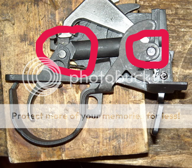

So i recently bought a m14, which i love to death. And i've been watching videos on trigger jobs etc, and i took the trigger group out and i was just working it in pulling the hammer back and dry firing it etc to work it in. But now the hammer won't catch and the trigger won't go back or forward, nor will the safety go back on.
If anyone could be so kind as to help me via skype i would be truly grateful!
I received your pm but am not set up for Skype .
The 2 pins I mentioned are circled in the pic. When dryfiring the trigger group out of the receiver these have a tendency to walk out of their holes a bit .
