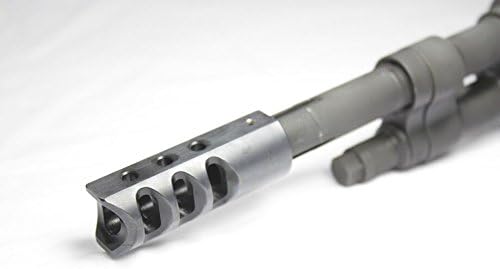

Been looking around for a good muzzle brake that has a sleeve to shroud the stubby 2 inch section of barrel that is between the thread and front sight/gas block. Can't seem to find any solutions. The closest thing i've come across on my search is the ACC deep socket flash hider for the SCAR H shown below:
